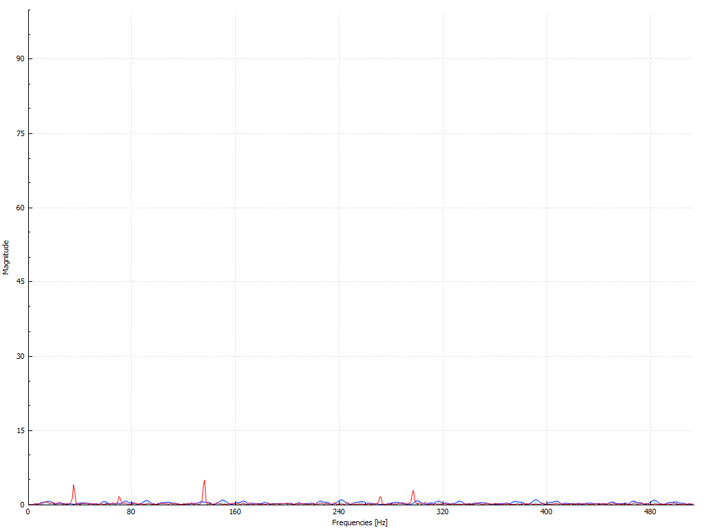

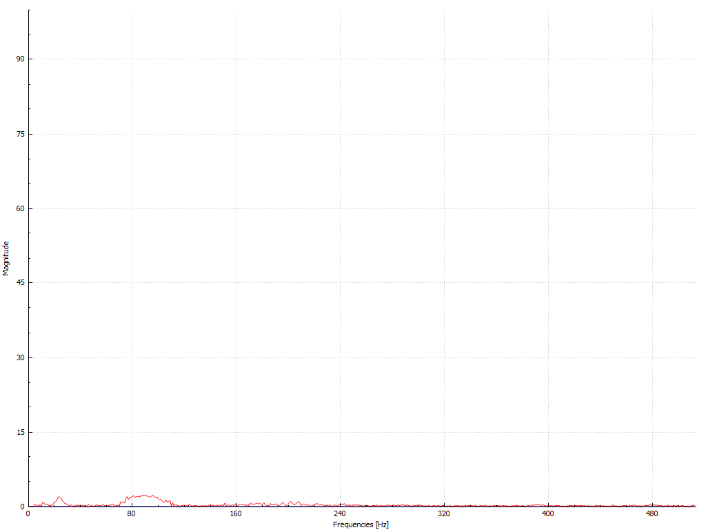

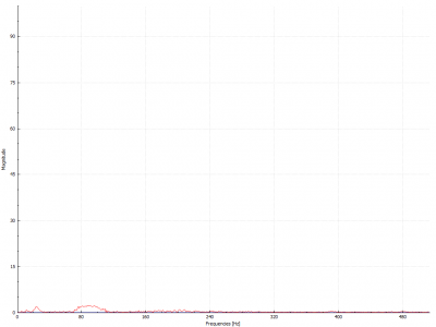

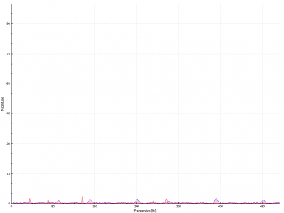

good morning sir. thank you for your support. I put a ferrite TDK, in throttle wire. and did make a vibration analisys. my heli have a 5 score . I think is very low vibration . sorry , but I dont speak english very well.
Posts: 12960
Vibration level is perfect if it is done with tail blades too.
