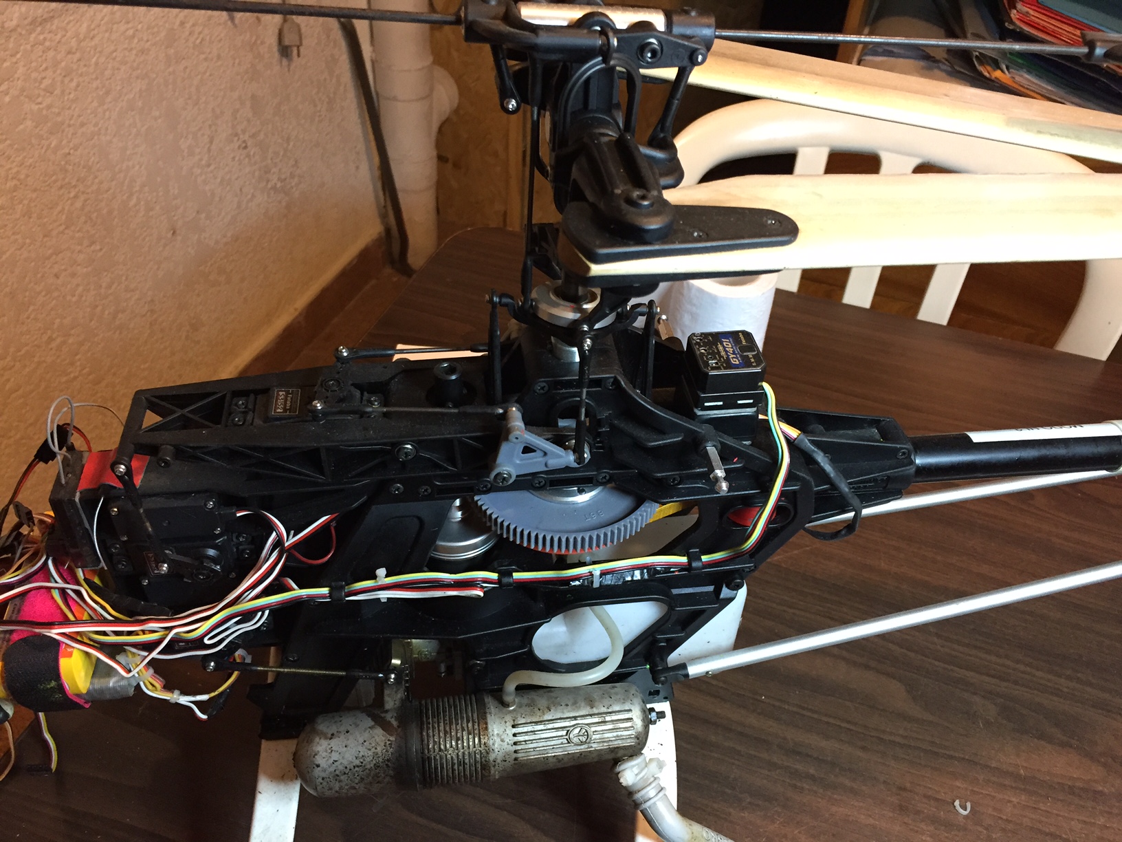

Can you help me setting up this heli? please, see picture attached.
Radio is a FUTABA T14SG with Rx R617FS
I want stabilization and rescue modes also.
Thank you very much

Do you want to use Flybar or Flybarless head?
If you want to use flybar, you can do so just be connecting the unit as in flybarless case, you have to perform all the settings normally and then you should just enable Flybar mechanics in the Stabi tab.
Then you are ready to fly.

I never setup this kind of servo setup !!!
I did several setup with spirit, but non with flybar and all the servos in the front of the heli!
Can I see any guide for this type of setup?

For example, what mix did I must use? (CCPM)
what model preset do you recomend?
Posts: 12832
If you want to use flybar rotor head,
then you can use preset for Trex 600, but it is not that important.
You should see in the manual of your helicopter what cyclic mixing it uses.
What Hirobo model it is exactly?

Heli was a Thunder tiger Raptor 30
goes down and touch floor. Please see attached log !
spirit-log-2015-09-13-203156.pdf
(96.43 KiB) Downloaded 96 times
Posts: 12832
What happened?
It seems that signal was lost at the beginning for some reason temporarily.
But this thread is for Hirobo, so I suppose that this helicopter is very different.

My mistake on the name of the thread, heli was a thunder tiger raptor 30, not a hirobo
Happens that servo connector of rudder and elevator get out because of the vibrations!!
At the begining, heli flyes at least 2 minutes great.
we dont had the oportunity to test bailout
I think you can close this thread
