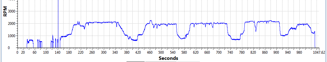

Hi, beginning to get my head around this. Still leaning the engine out and will try some different settings. Only tried 4&4 and 5&4.
It looks like it does prevent overspeeding quite well. I also want to have a careful look at the servo resolution and linkage position.
During this tank, I landed, made small carb adjustments and took off again. I fair bit of pitch pumps and FFF with lots of load.
Ps. Not sure why the spike is there.

Posts: 13047
Hi, thank you for the report.
I am sure that you can make it better, especially with Governor Response.
You can gradually increase it, until you will see overspeeding during for example pitch pumps.
