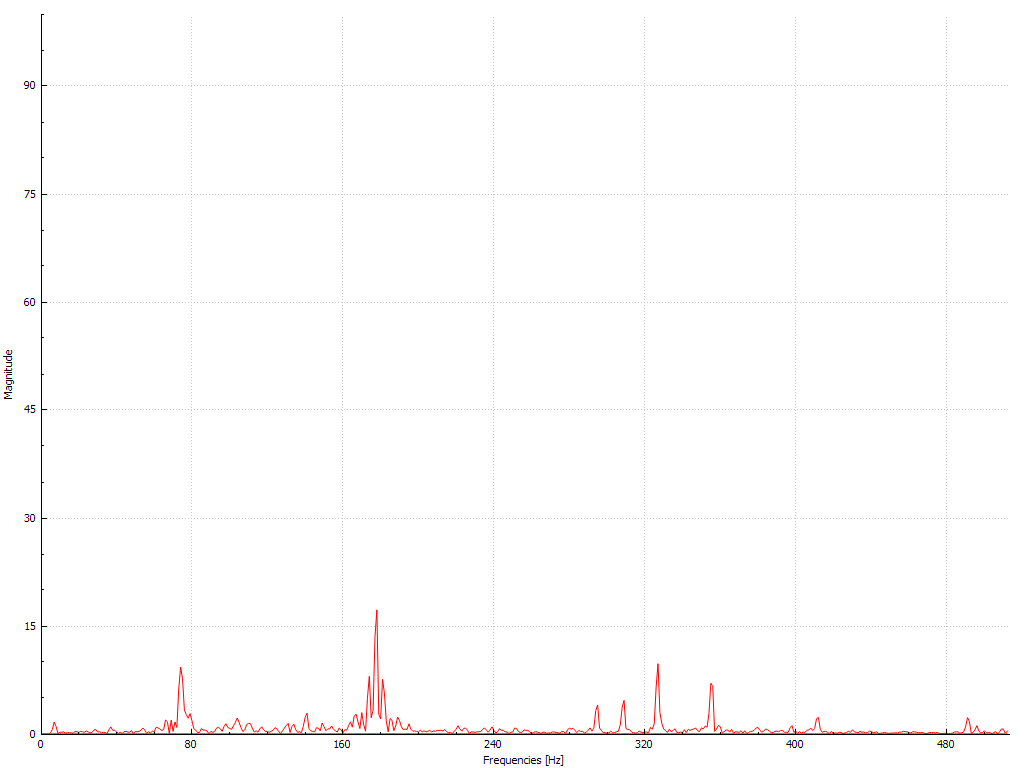

I did a vibration analysis and was impressed how easy I could get ridge of tail vibration.
rpm 2100 (35Hz) / Gear 8.85 (309Hz Motor) / Tail 4.8 (168Hz)
Took Main Blades of and released tail servos to move free.
I did start with a 60 Peak on Y-Axis
I did add some tape on one tail blade (around front edge in the middle/center), ending with 120 peak, so wrong blade. Moving it to the other blade, got better results. Making it smaller, thinks look great now.
