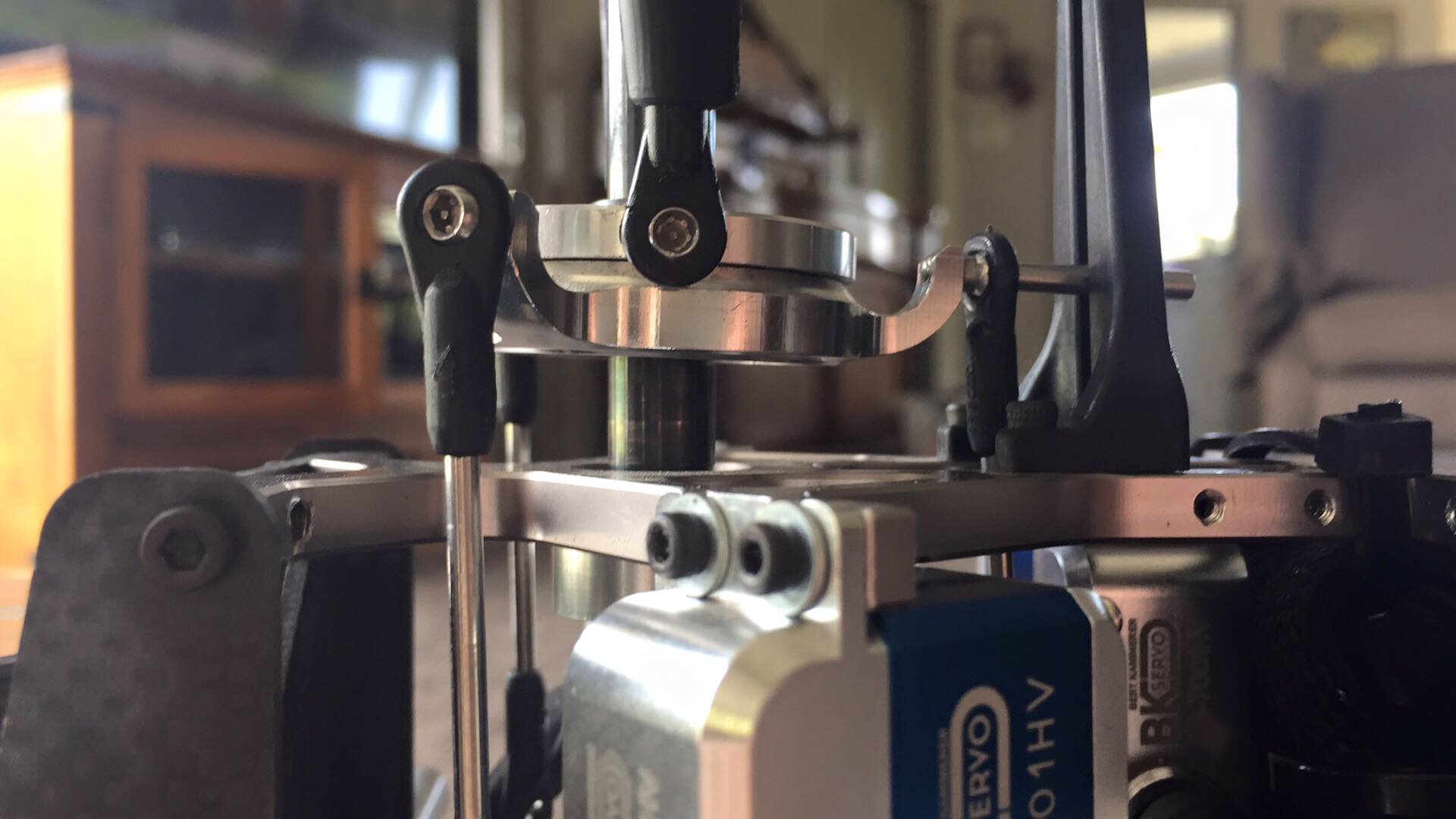

Is that the swash is leaning back after initilization, when it sets "level", the swash is not level.So when I first plug in the power, the swash is perfectly level. After it has initalyzed, and the servos twitch and jump etc, the swash has set "level" but the swash is leaning back. My elevator servo arm does not go to 90* at mid stick like how I set it, instead it's down further causing the swash to not be level
It's like the subtrim hasn't been set properly but I got it perfect this morning, set save, went for a fly and noticed the piros are wobbly and my swash was not level when I landed.
I have a very quick video I will try to post.
Is this still likely to be a servo shorting issue?

Edit- can't post the video for some reason.
But here's a pic showing the unlevel swash after initalyzation
Non-level swash plate

Again another discovery, just trying to give people as much info as possible... This is very weird
So the swash was always leaning back. So what I did is go back into the software and adjust subtrim again to get the swash PERFECTLY level at midstick, and to stop the swash from leaning back.
So that was all good, pressed save, quit software, unplugged spirit and unplugged my lipo.
Plugged the lipo back in, waited for the spirit to boot up and servos twitched, bam my swash plate is now leaning forward after initalyzation
It's as if the subtrim is tricking me in the software, and when not connected it's different
Now, to add more to the puzzle... To make sure it's NOT the servo, I swapped the ELE servo port with the AIL servo port on the spirit...
After initalyzation the swash STILL leans foward, but ALSO slightly to the left. When I swap them back it only leans foward. (This was done without my TX connected by the way)
This is very very puzzling :?: :geek:
Posts: 12921
You should set and verify subtrims only with Subtrim (tuning) enabled.
If it is disabled, there are algorithms that can change the level.
