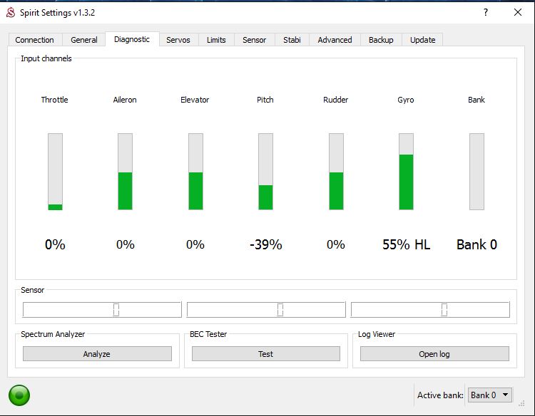

As coco66 ask, I did the proper travel adjustment on my tx.
Low travel adjust on my tx to match 0% in the spirit software is 59%
0% on throttle

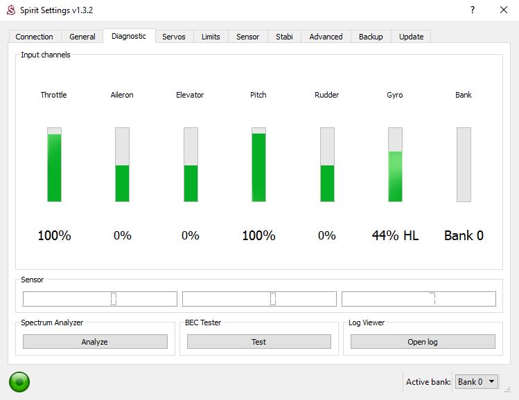

High travel adjust on my tx to match 100% in the spirit software is 69%
100% on throttle
100% on throttle

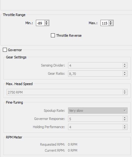

I increased the min max value in the spirit gov. tab until the esc beep for high and low value.
Travel adjust on the spirit gov. tab.

Low travel adjust on my tx to match 0% in the spirit software is 112%
High travel adjust on my tx to match 100% in the spirit software is 72%
Guess what, the 3 head speed are working.
So, my only conclusion is that the software does not send the 100% signal to the ESC. This maybe because I need to go as low as 69% on the tx high travel adjust to match the 100% in the diagnostic tab.

1- In the spirit software gov. tab, set min value to -100 and max value to 150
2- Save and close
3- Set my TX in PPM mode.
4- Connect the ECS directly to the receiver and calibrate the throttle
5- Change TX seting to Xbus mode B
6- Connect ESC to aux 1
7- Open the spirit software.
8- Place my throttle stick on my tx to 0. (diagnostic tab is at -10)
9- In the spirit software gov. tab, add min value of the diagnostic tab to the min value of the gov. tab. So, -100 + -10 = -110
With the above step, my 3 head speed are working perfectly!
