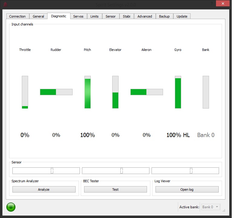

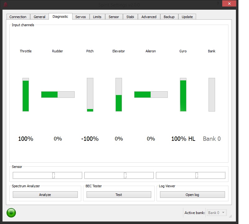

2) have you been able to setup diagnostics to match 0..100% in Spirit?
I have. In my transmitter (DX9) they are 101-high and 99-low.

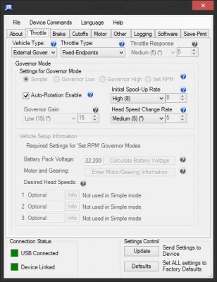

3) have you been able to set ESC in external gov mode?
I have.

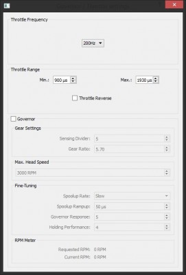

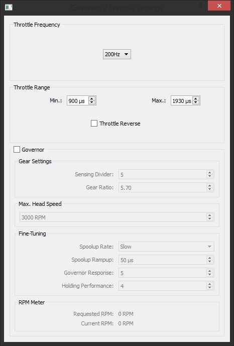

5) have you set in spirit Gov Range min to 900us and max to 1930us? This is very important.
Yes I have.

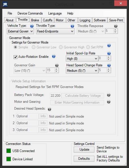

As far as your guide, I was able to get to get to "Spirit with Firmware 2.0 Preparation." The part I get stuck on is setting end points, it seems that my ESC is just not getting the signal/getting enough signal from the FBL. Therefore I never get a chance to set the endpoints and finish the setup.
I've attached a picture and some screenshots, just in case you see something I can't.

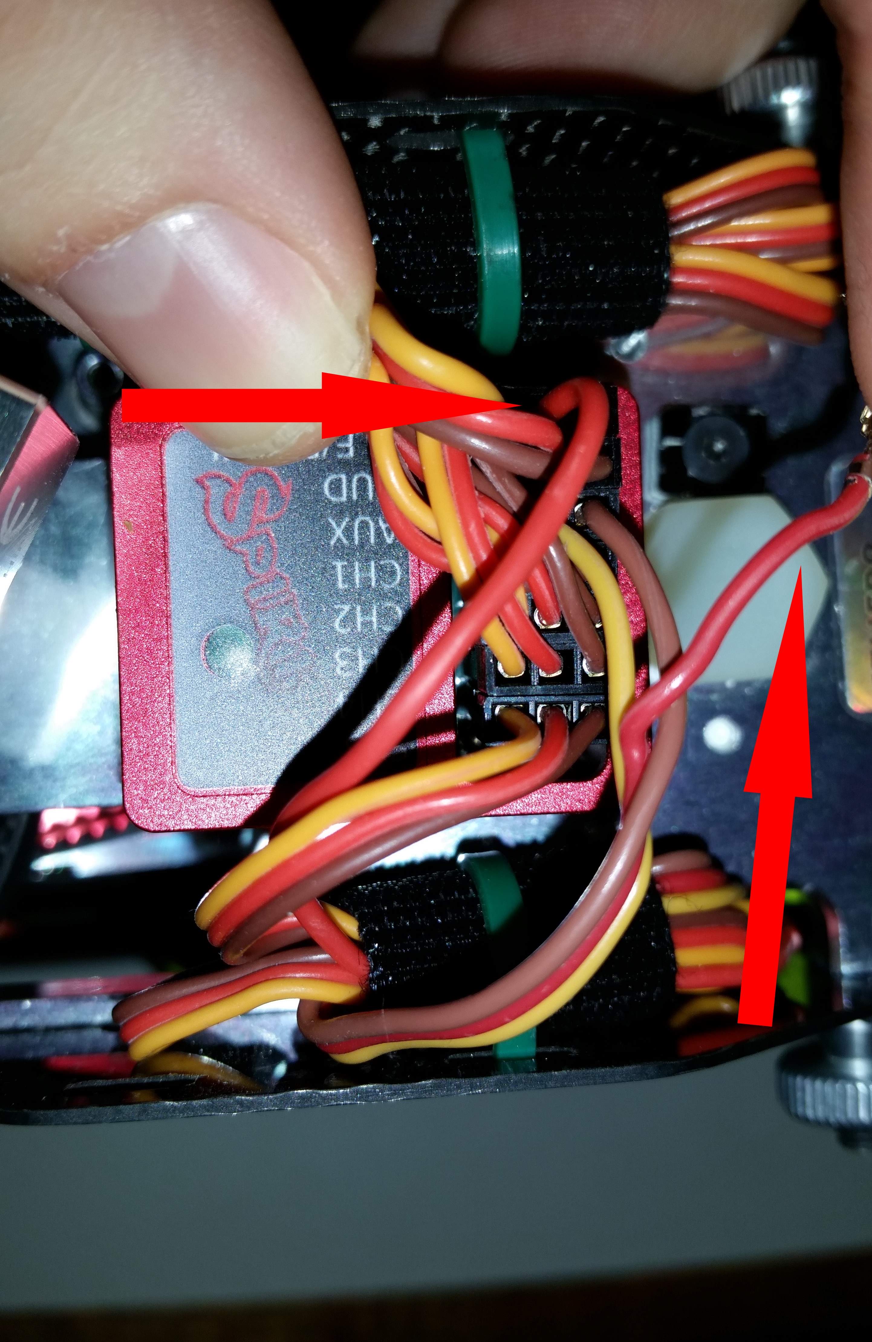

The top Arrow is showing the Gov wire from the ESC, I had to make an extension to get it there, which is why it is red.<br /><br />The bottom arrow is showing the red ESC wire pulled from the connector since I'm running a BEC.
