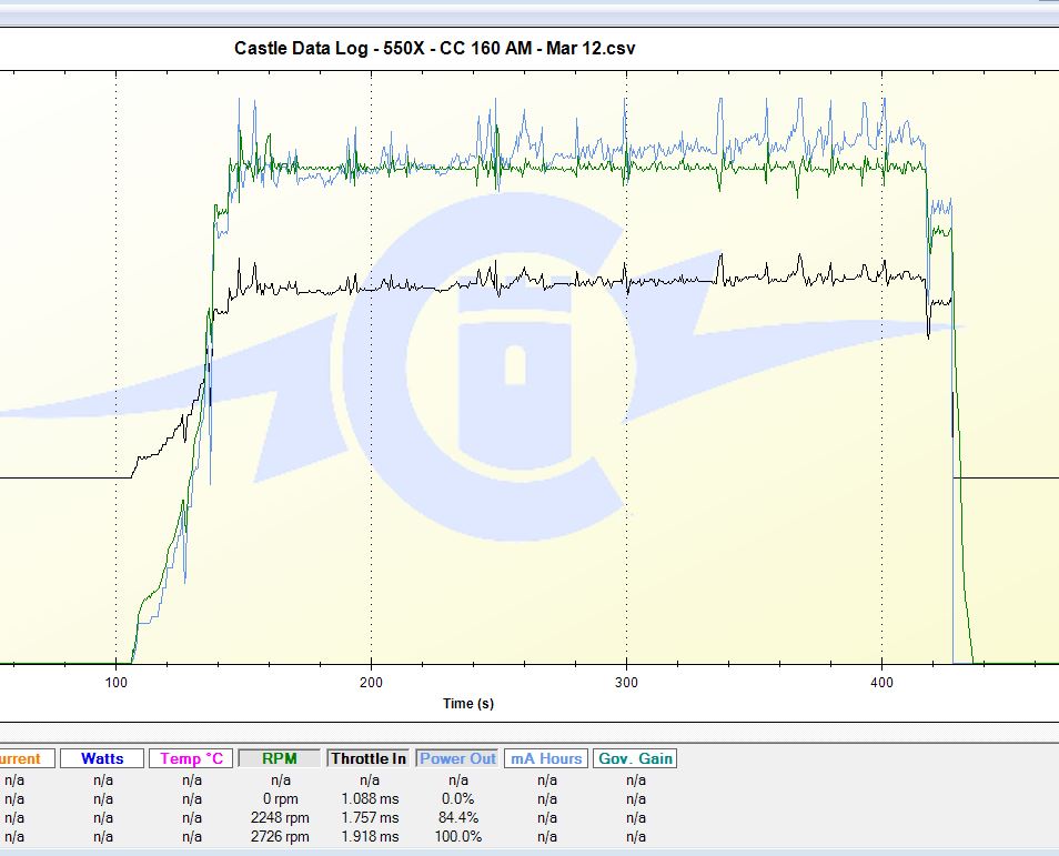

Dawiev

RPM in green, Throttle in Black and Power Out in Blue.

velocity90
Posts: 252
Joined: Sun 26. Oct 2014 9:53:53
Perfectly fine, pwm should not touch 100% a lot or even show straight lines there.
