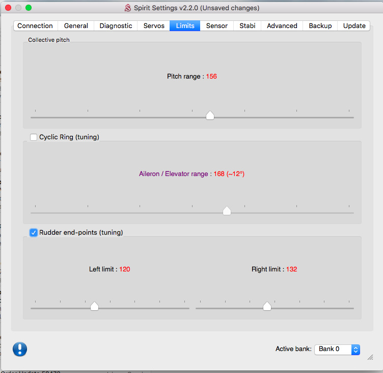

Just wanted to update on what I've done since coming home based on your suggestions and on HF too.
I did some digging to see what distance most Gaui X3 owners set their tail servo ball from servo arm centre. Most were between 7 and 10.5mm. I was at 14.5mm. I had 2 holes closer than the one I was using; the closest being 8.5mm and the middle 11.5mm. I figured I'd try the 8.5mm one based on the 7-10.5mm range others were using. Once I got hooked back up, and went to set the Rudder Endpoints, the Spirit Software told me the Endpoint range was too high. It was over 150 and I could see binding where the pushrod exits the X3's frame near servo.
I then moved the ball to the middle position at 11.5mm, which wasn't flexing the pushrod toward the servo as much, and then eyeballed 3-4º on tail blades with the pitch slider toward the boom. Then with the tail servo centered, I moved the ball link inward so that the 3-4º was locked in with the rudder servo in center position.
From there, I set endpoints and are in a happy zone of 120 and 132, and backed off slightly more than I did last time after binding is induced, (maybe 1mm on each side from binding).
I bumped up the gyro gain back to 60% from 37%, set Rudder Delay of 4, Rudder Dynamic to 7, and Piro Consistency to 170.
Am hoping that these changes make that tail perform as it should now. Uploading images for your perusal. Thanks!

Posts: 12988
Good job. I am sure that you are on the right way.
In any way, it is important that there is no bending of the push rod - even slight flexing (at the ends) can cause a worsened performance. But it is still better, than when servo arm is too long.
Yes, for this helicopter it should be somewhere near 10mm.
