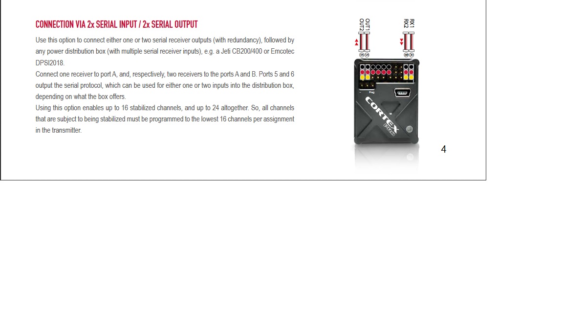

Hello
It is also possible to loop through the Jeti EX-Bus signal and forward it to a CB200?
The servos attached to a CB200 as the Cortex Pro is the case?
Would be useful for models with multiple servos ....
As in the picture.
Posts: 12988
it is possible with all our units even before Cortex supported it.
Regarding servos, you can do this, but the unit can't control them (only your transmitter).
I believe that this is same with Cortex, since there is probably no way, how it can be realized with current protocol.

Hi
Only to the correct position, with the Cortex Pro is the Gyro but usable in connection with EX bus and CB200.So it is in the instructions ...

Posts: 12988
Maybe it depends on interpretation. But as I have written previously, with Spirit you can also use CB200 + EX Bus.
If it will be technically possible to move servos through EX Bus, we can implement it - this should be easy.
We will ask Jeti if they plan to release the feature.
stipsi
Posts: 36
Joined: Fri 10. Mar 2017 17:27:00
Here is an excerpt from the description ....
