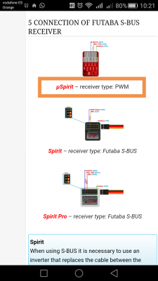

Hi Tomáš,
I found a small error in the manual, all the uSpirit pictures in Wiring say "PWM".

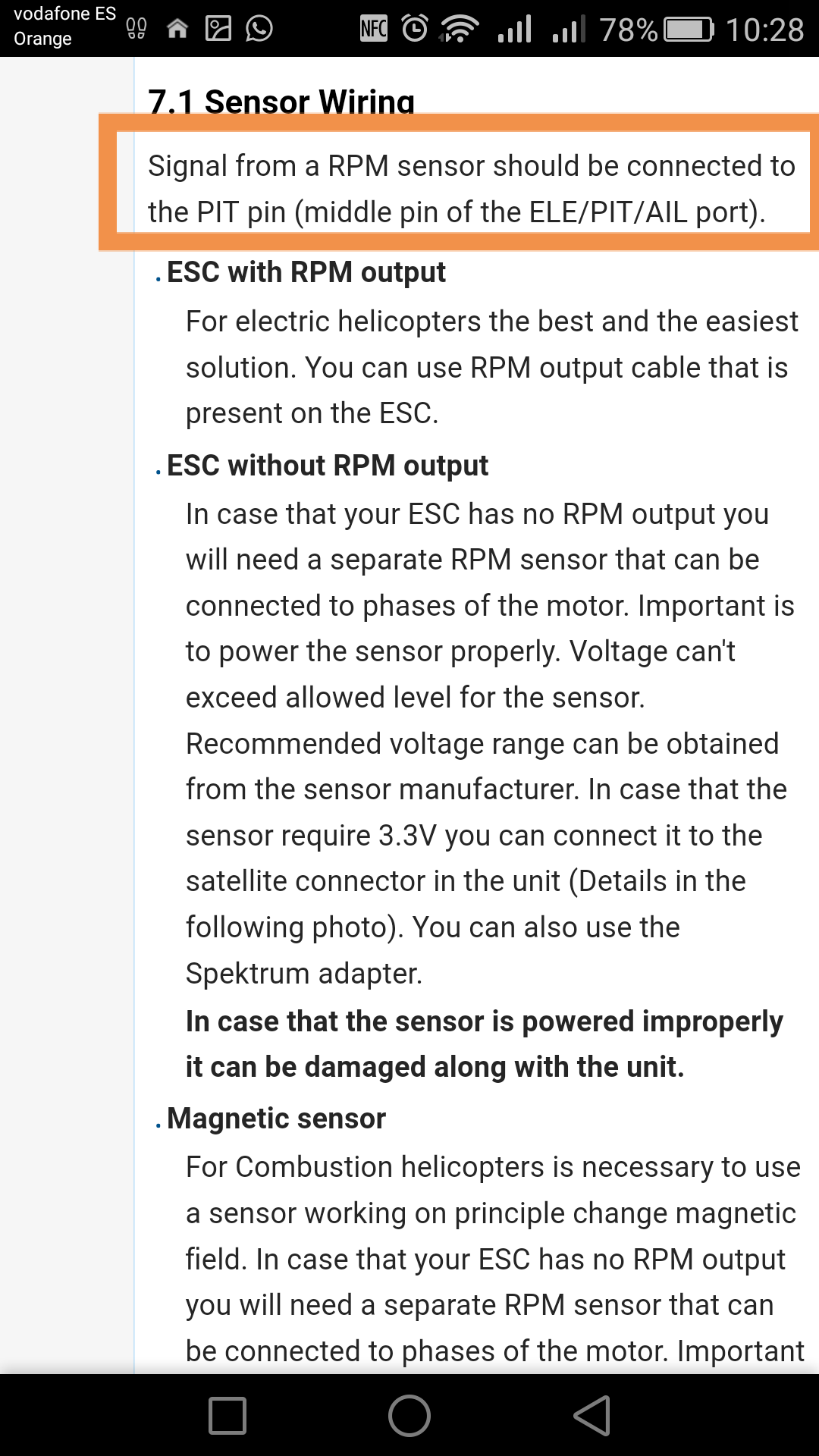

One question also: if Ele/Pit/Ail became Pit/Ele/Ail this most probably also impacts RPM sensor wiring so there should be different pictures there also.

The manual is in development right now. So it will be corrected.
Thank you for your help!
