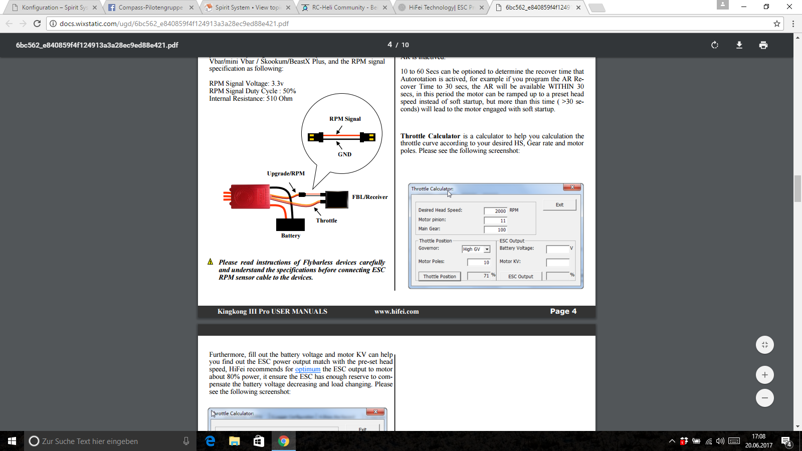

A question about governor
I'm just a regulator, the internal not so great regulates with the Spirit to connect
Now is written in the manual, Yellow in Pit pure! But my regulator has still the mass speaks brown and is therefore two-wire
Where do I get it?
Mfg Sascha
Posts: 12831
disconnect the black wire from the connector. Then it will work.
