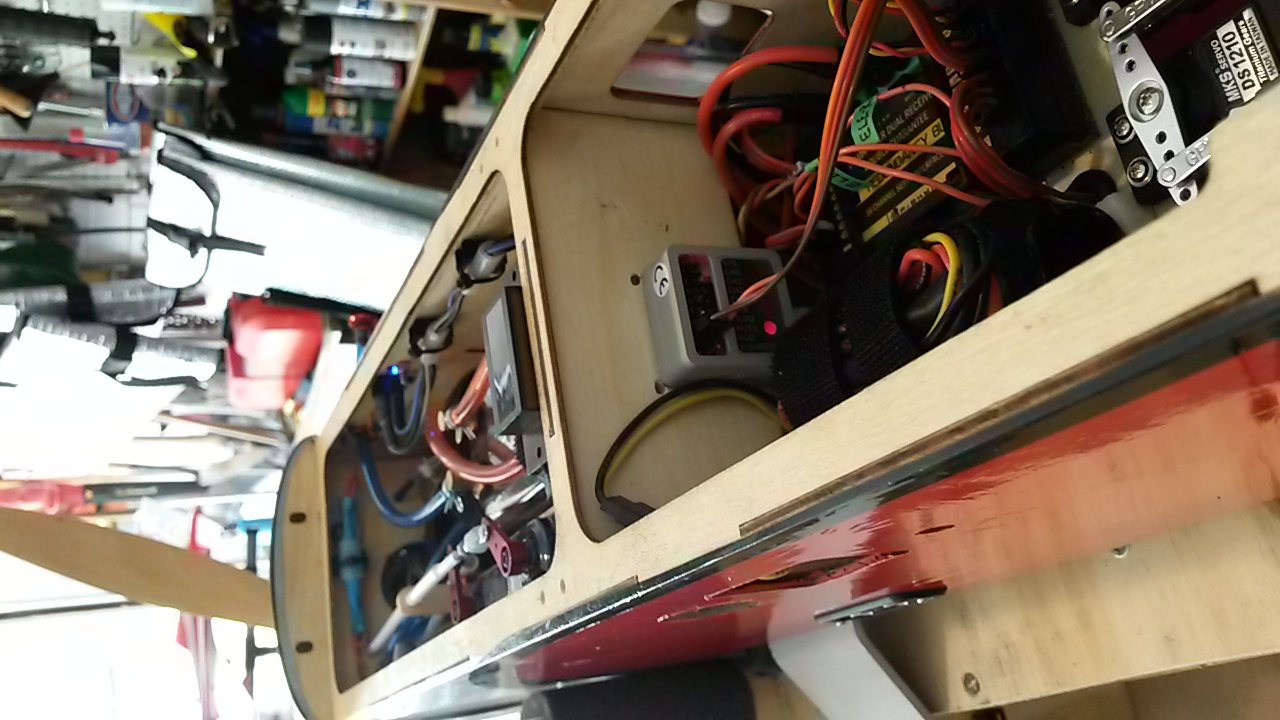

Thanks for responding.. here is what I had in mind... not sure why my pictures are always turned there there side... but you can get the idea... no room to put on floor or on the side of the plane.

Not sure what you have is feasible...
Put it on the side and use one of the Vertical options...
(Inverted is "upside down")

They should say "upside down" ! this was one of the main reasons for this purchase... it has the same problem as the Cortex Demon! to me... this seems like it would be a logical option.. if you mount this devices on the side of a plane your not in the center of the plane... can't see upside down of any use... so if it can't be fitted on the floor there isn't a good option... that's a shame, I guess I will try to make a tray off the wall and hope it doesn't vibrate to much... thanks for the help!!!

Coco66
Posts: 433
Who cares if it's in the center of the plane? Does not need to be! Mount it on the side. Vertical. You think they are stupid or what? ))))))))
(BTW, upside down position comes from the heli world)
Posts: 12960
Position as of the Photo is really not supported at the moment.
Unfortunately from technical point of view it would be also not optimal regarding vibration transmission.
Place where is your receiver is perfect for the units, while place where you have unit right now is great for the receiver or other boxes that can be anywhere.
Yes, you can mount the unit on the "wall", it does not matter if it is in the center.
