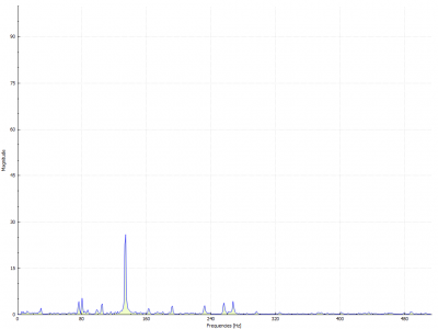

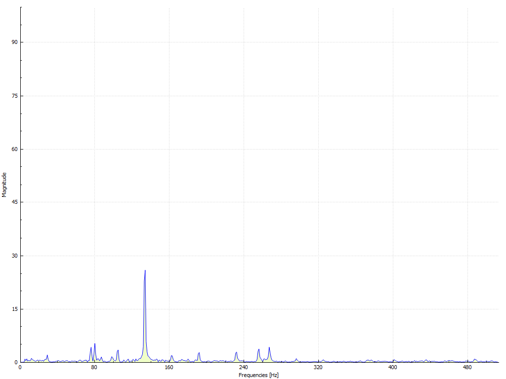

I have attached the vibration analysis for tail blades on, you can see a little spike which I have been unable to reduce any further through balancing, otherwise the spike is completely gone with tail blades off.

This plot looks very good. If it looks like similarly on all 3 axes, then it is definitively pretty OK.
I have just noted that you are probably using some older firmware/software version. Maybe newer version could improve it, although I dont know about any particular change that should affect this behavior. But you can leave it as one option to try that is worth also for other reasons.
