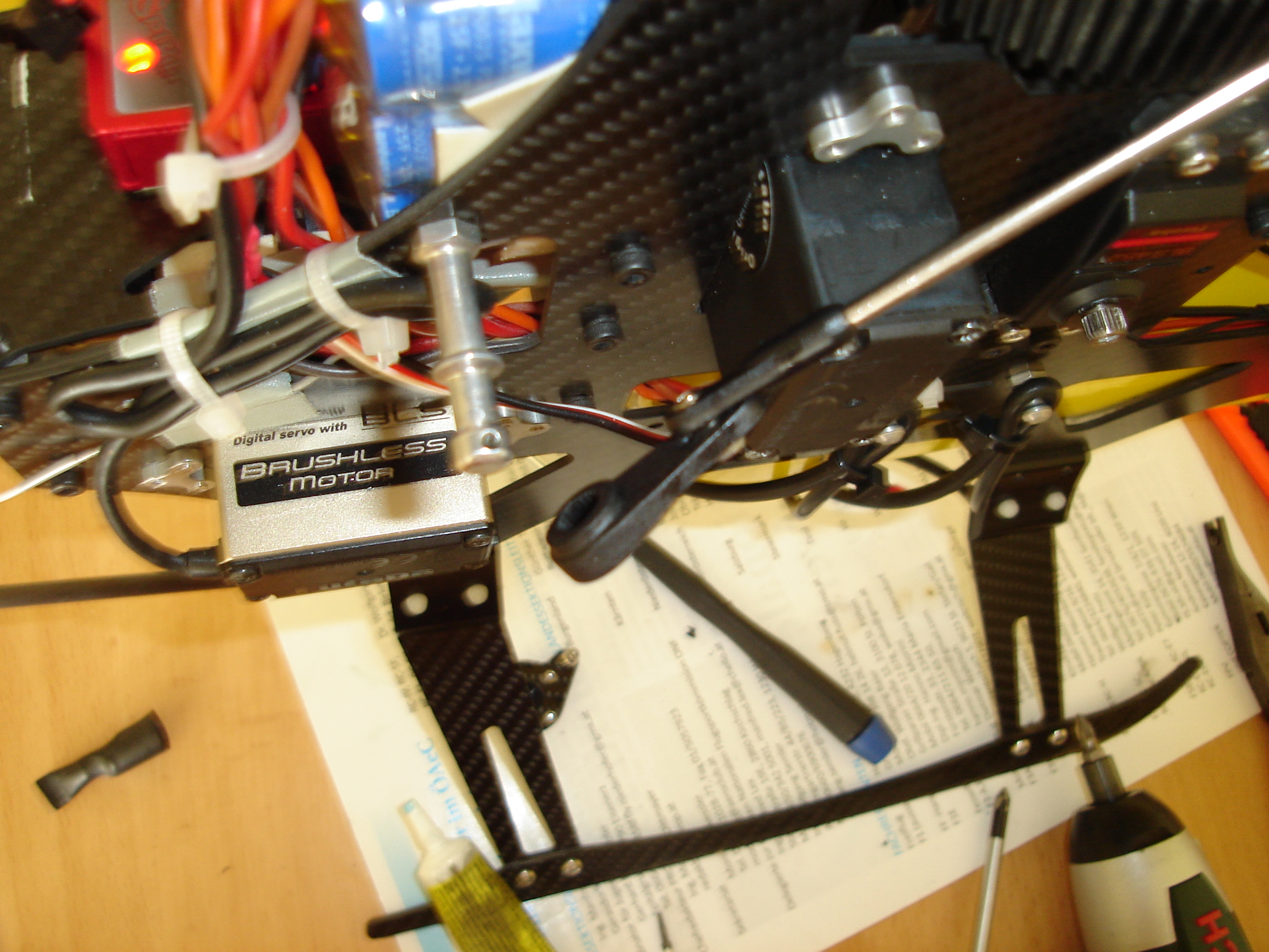

I have changed from AC3X V3 to Spirit red. Firstly, i used the already attached servo horns, but with Spirit the linkages of the Roll servos bend on the servo horn.
Then i changed to Mikado horns. Now the linkage screw bend on the servo case in the upper direction. I could get rid off that by setting cyclic ring to 105 but then i were unable to reach the cyclic rates.
With AC3X it was not a problem, since there is a travel limit for each servo to set. It may be the only system that can do that.
I have considered going back to the original Voodoo horns and grind something off the horns, it may work then.
There i have 16mm, with Mikado 17mm or 17.5mm distance on the horns.
Here´s the not finished setup. It´s important to me to get rid of that bending issue.

servo arms should be always be so that push rods are perpendicular to the swashplate in all axes.
If you will limit one servo differently than other, then this will result in an inequal rates for some sides. So all servos should be limited in the same way. If there will be limitation for bigger angles, then you will feel kind of "stalling" in a pirouetting maneuvers as there will be low angles.
If you can observe a difference in limits for each servo, maybe the problem is in the Subtrims - all servo arms should be at the center when you tick Subtrim (tuning). Can you confirm it is in this way?
For Spirit you can limit Cyclic angles and Pitch angles.

The mechanics are set correctly. Servo arms 90° to linkages at 0° Pitch as mentioned in Voodoo´s manual. Max min Pitch is at 12°.
As i said, i´m going to grind off a bit to make it work.

Now i´m using SAB arms on 17mm. I get 12° pitch and 10° cyclic at 0° pitch. But it seems that this is still too small. With AC3X I was capable of having 14° pitch and 15° cyclic without binding because of servo travel limit. It seems Voodoo is only made for AC3X :shock:

Ok, now I got 13° pitch with 12° cyclic. It flies a bit better, it seems he really needs much cyclic. I´m using the Mikado arms with the Mikado ball links with phillips screws.

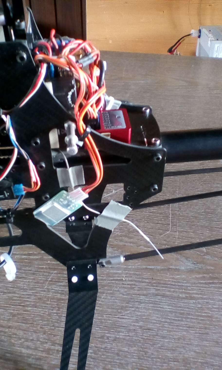

This is the mounting of the Wifi module. It seems to interfere with the radio. I wanted to open the log, suddenly the motor starts spinning.
Servos are BLS 251 and 452. Voodoo is about 4,8 kg with 12s. Also DH 711 Flybar are used.
