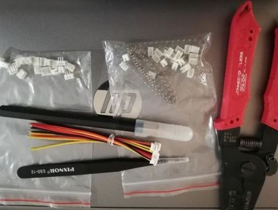

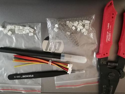

Perfect,,,then I start to see the prices of the servos and then choose. for the connectors, for me non problem,
I can calmly crimp a bit of everything, I have also been tuned for the JST ZH series as photos
