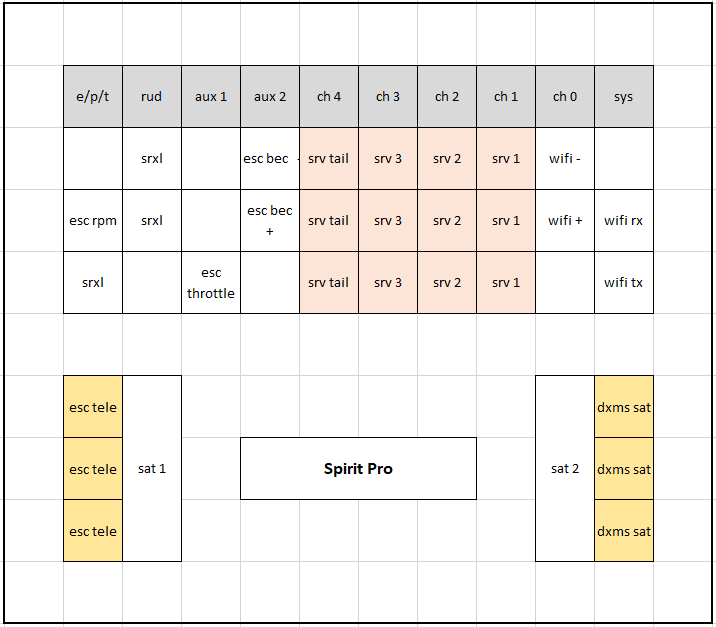

- Spirit Pro,
- WiFi Link for it
- ESC HobbyWing Platinum V4 120
- Spektrum SPM4649T
- DSMX satellite (will add soon)
I'm confused, as it seems I have to connect ESC RPM signal and Spektrum SRXL both to same port - ail/pitch/ele - is this correct? (will need to hack some wires if this is true).
Also confused, why signal wire for SRXL has to be moved from RUD port to ail/pitch/ele to use Spektrum integration?
Also, the manual states I have to use the female port of the SPM4649T - aren't these two ports it has same?
Could you please confirm if my diagram is correct?
Excuse me too many questions
