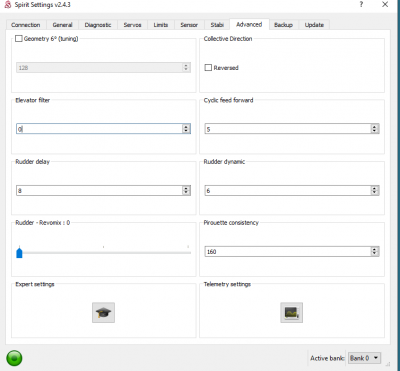

Ok , I am attaching a screen shot of my configuration of the geometry of the cyclic, I left everything by default (facotry setting) is that good?

Hi Tomas I put the servos at 200 hz in the unit, better placed the wiring and stopped the unit with a new plate, and I put the filter elevator at zero, but another value and if I correct correct me, it seems to have improved before all these changes lowering the value of the cyclic gain on 45% before it was at 55% However I resolved, now the servos are not even lukewarm.
