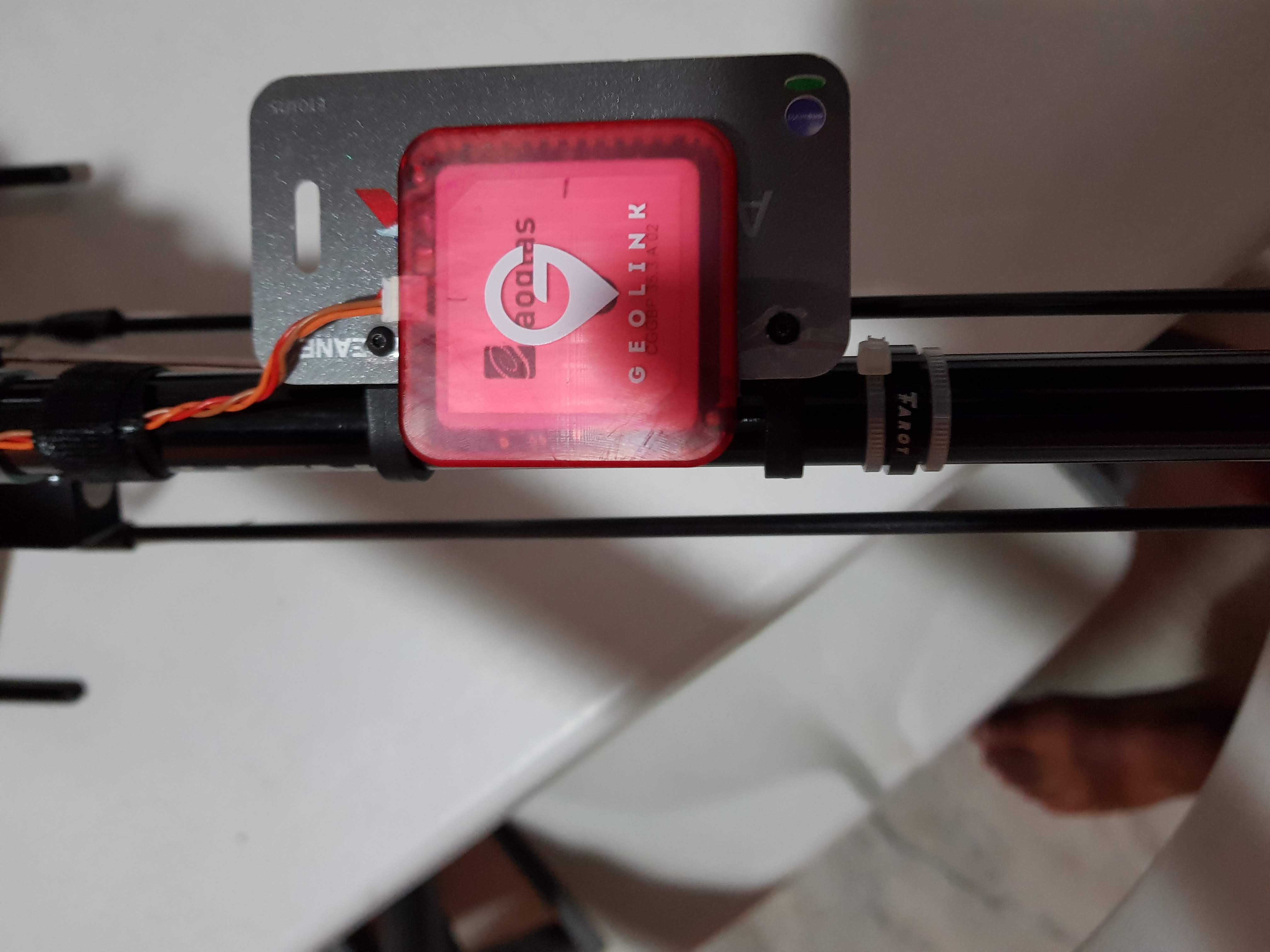

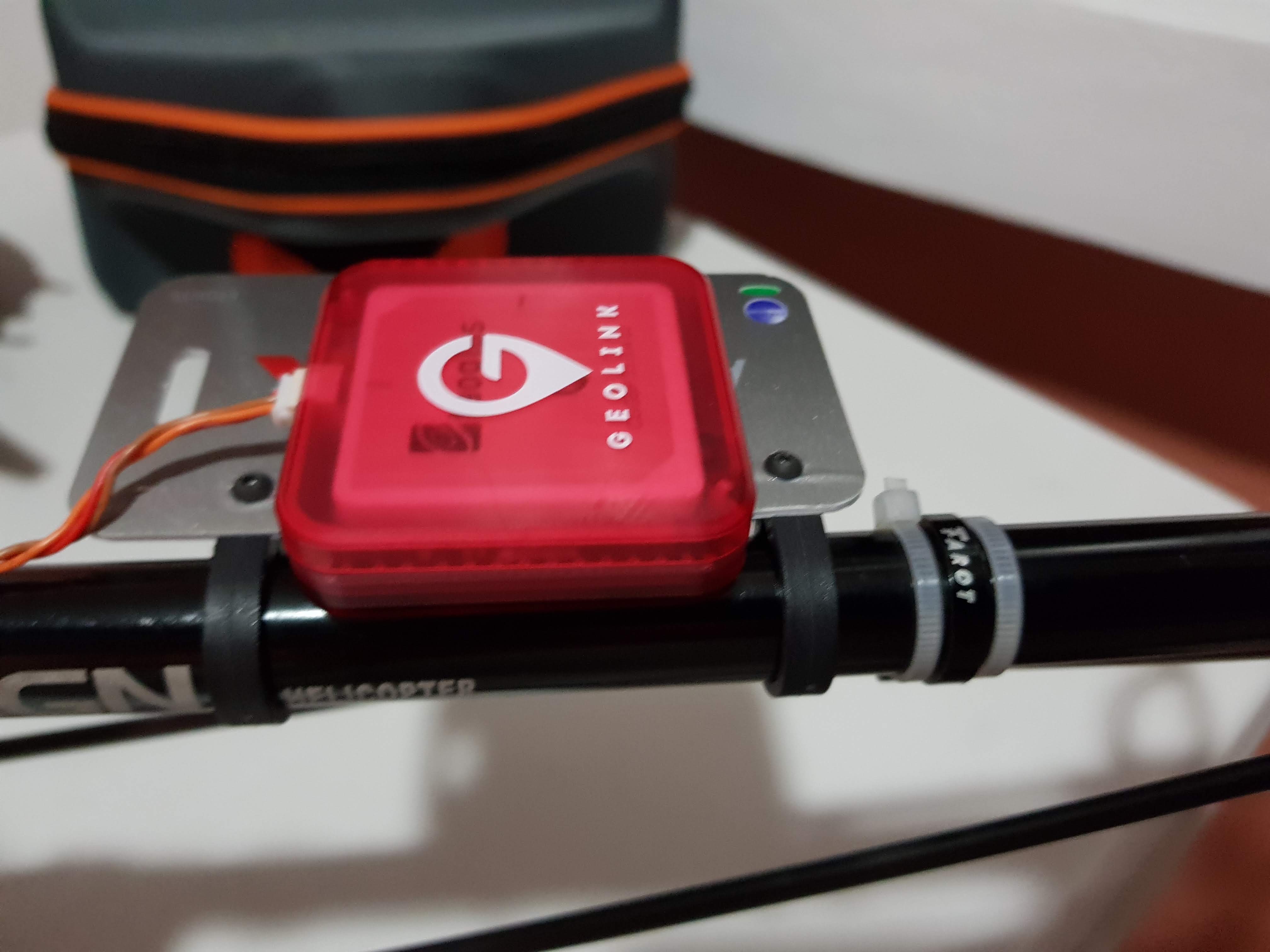

I successfully maidened my Trex500 with a Geolink on an old Spirit FBL unit bought in late 2014. I mounted the geolink onto the boom with two plastic brackets normally used to hold the tail servo holder and screwed them onto a stiff plastic luggage tag. I had previously tried to use a piece of carbon fibre instead of the luggage tag, but had problems getting the compass calibrated, possibly because of the carbon fibre.
