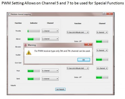

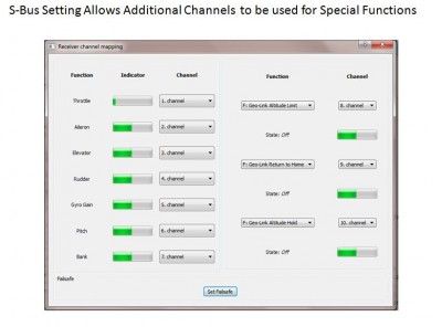

From my testing below it appears by Selecting SBUS Tab, you can then assign 3 Special Features on the right with no limiting message.
So it appears it will allow you to have 3 special functions on those remaining channels after I switch to SBUS! Outstanding!
See details below.
UPDATE - ANSWERED MY OWN QUESTIONS (I should of thought of this already!!)
I was able to answer my questions above by doing the following:
Start the Spirit Pro Software without having your helicopter connected to your computer
Wait for the small window to pop up saying no device found, Do you want to run in Demo Mode?
Click/Select Demo mode,

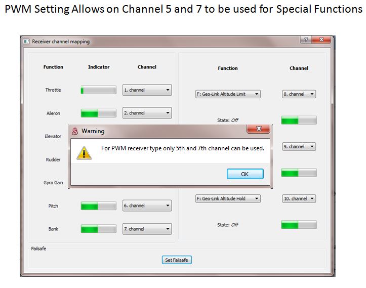

Go to the General Tab and Select PWM Tab, then try to assign 3 Special Features on the right, you will get a message box only 2 can be selected on either channel 5 or channel 7.

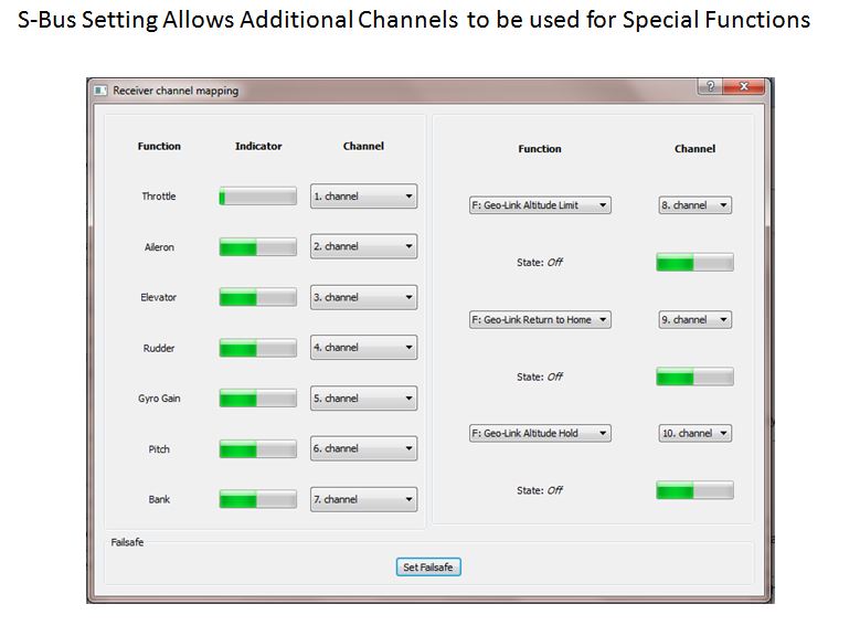

Go back to the General Tab and Select SBUS Tab, then try to assign 3 Special Features on the right, it appears it will allow all 3!
See the pictures below:
