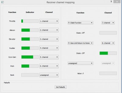

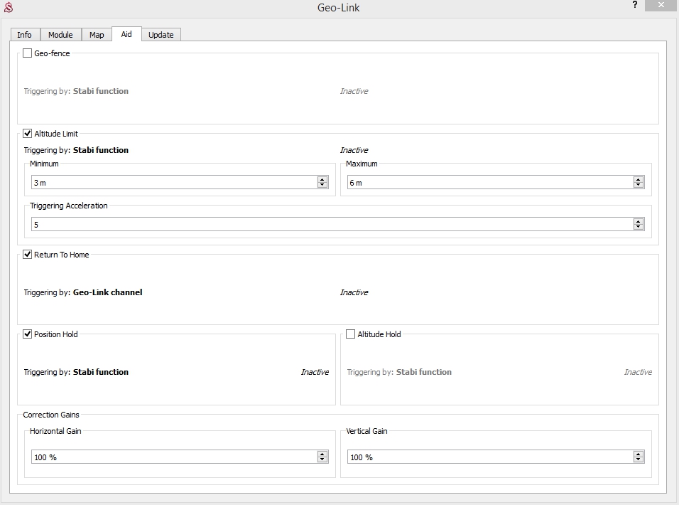

I had assigned a 3 position switch for the Geolnik Return To Home function as the manual advise:
It is possible to program the Home position either with the Spirit Settings by selecting a point at the Map. Or there is possibility to use GeoLink channel to do so even if you are out of a computer.
If assigned GeoLink channel is used you have to set On (2) function state and keep it on for at least 2 seconds. At this period Status LED of the unit will turn off and after 2 seconds new Home position is programmed. Once finished the LED must turn On again.
When I activate the On(2) position for new home position programming, I could not see the LED indication as mentioned in the user manual. The LED stays ON at all the time. However, if I connect the FBL to PC program and check the map, the new home position has been registered. Please see below my Radio channel assignment and Geolink feature selection.

Is there anything wrong with my setup? Does the Geolink function correctly for new position assignment ?

are you checking the Spirit status LED or GeoLink status LED?
The position is programmed in the Spirit unit so you have to check the Spirit unit.
Yes, all seems to be correct if you can see that position is reprogrammed and also at the correct position.

Dear Mr.Thomas,
Thanks for the replies. Yes, I was looking at the GeoLink unit. Actually, I notice the blinking on Spirit unit but I didn't take it to account. Then everything seems to be okay with my setup.
