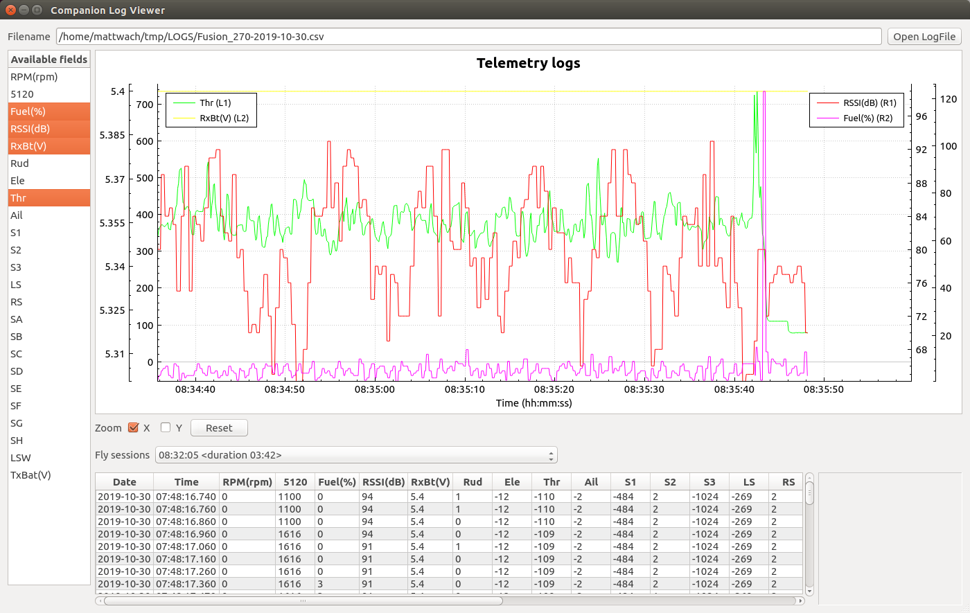

I looked at more data and ran some tests.
The opentx log is attached. The green spike at the end shows where I applied collective to autorotate.
The voltage to the receiver (yellow line) is solid throughout the flight.
RSSI (Red line) looks fine.
Fuel % (magenta line) has an interesting jump around the problem time. I have no idea what this telemetry value is trying to tell me. I think the spirit is generating it?

Posts: 13059
thank you for very detailed description.
What was displayed at the flight log is unfortunately very likely wrong. But I am unable to tell you why this happened. It is possible that it was stored for a longer time there from a previous testing.
Double initialization is really not looking well. It is related to your BEC maybe. I recommend to perform BEC test for at least 2 times.
Maybe you saw a different kind of initialization caused by engaged Rescue mode. If rescue is engaged during powerup then it will show this notification. You can verify it if this was the case.
If you were able to control the model even during this event then I am convinced the unit operated properly. The ESC might turn off due to overheat or possibly due to a moisture that could develop if it is heating up. Unforuntately I fear the problem will occur again. So I recommend to perform testing on the ground with a similar temperature condition at the moment.
Starting motor without blades for several minutes during similar temperature should reveal more.
