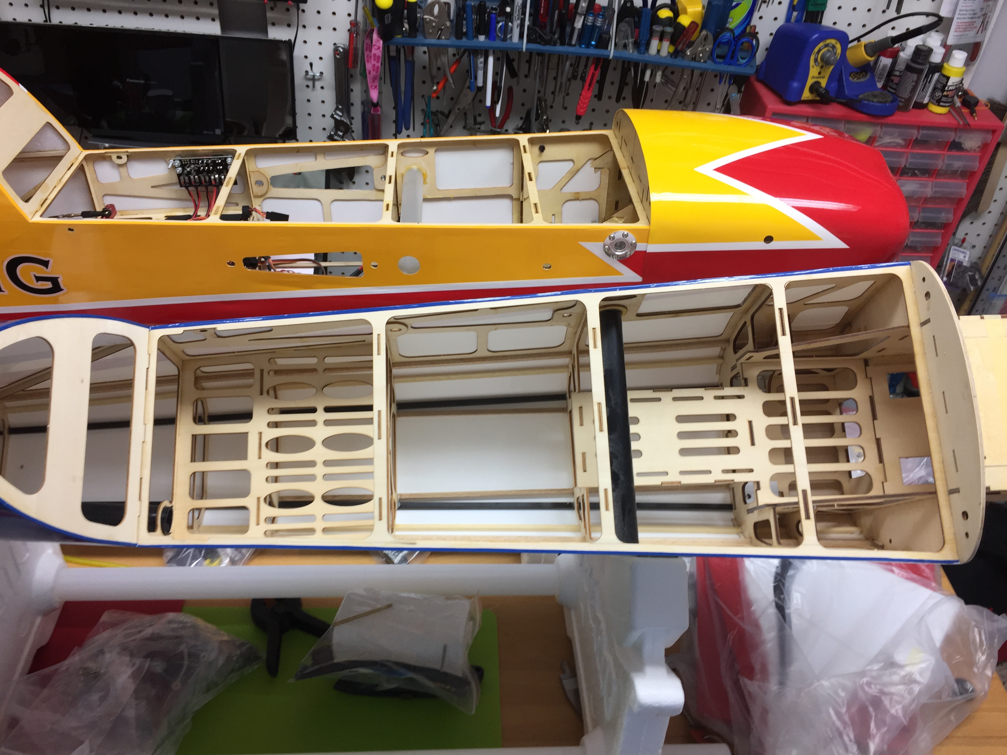

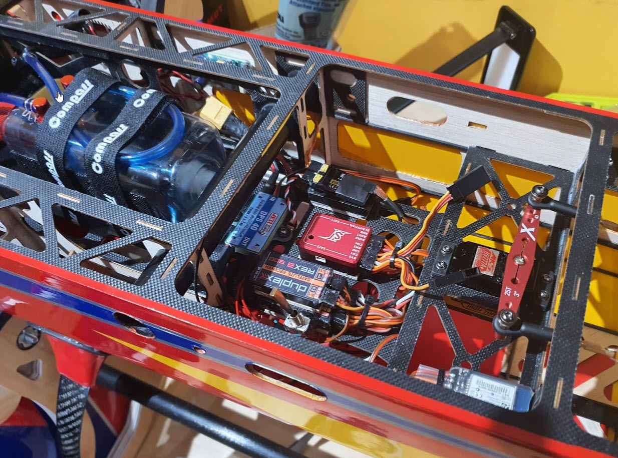

I have the same dilemma. I have the Spirit 2 mounted as shown - yet to fire her up so I don't know what the vibs are like.
I am wondering about moving it to here:
I would leave the RX where it is (Jeti EX link) but I don't know if extending the distance between FBL and RX is a good idea.
Suggestions welcomed. I had a JETI assist RX in a similar plane and that didn't go well due to vibs. I am hoping the Spirit 2 is more resiliant.
