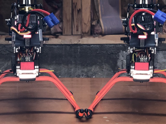

Maybe units are mounted differently on both helicopters.
It is also possible some other parameter is not Ok - and it wasnt all the time. With the latest firmware it might be apparent.
What is different between these models?
The motors are different, but the Spirit configuration is identical. See the attached photo. I also attached the saved V3.0.0 profiles.
