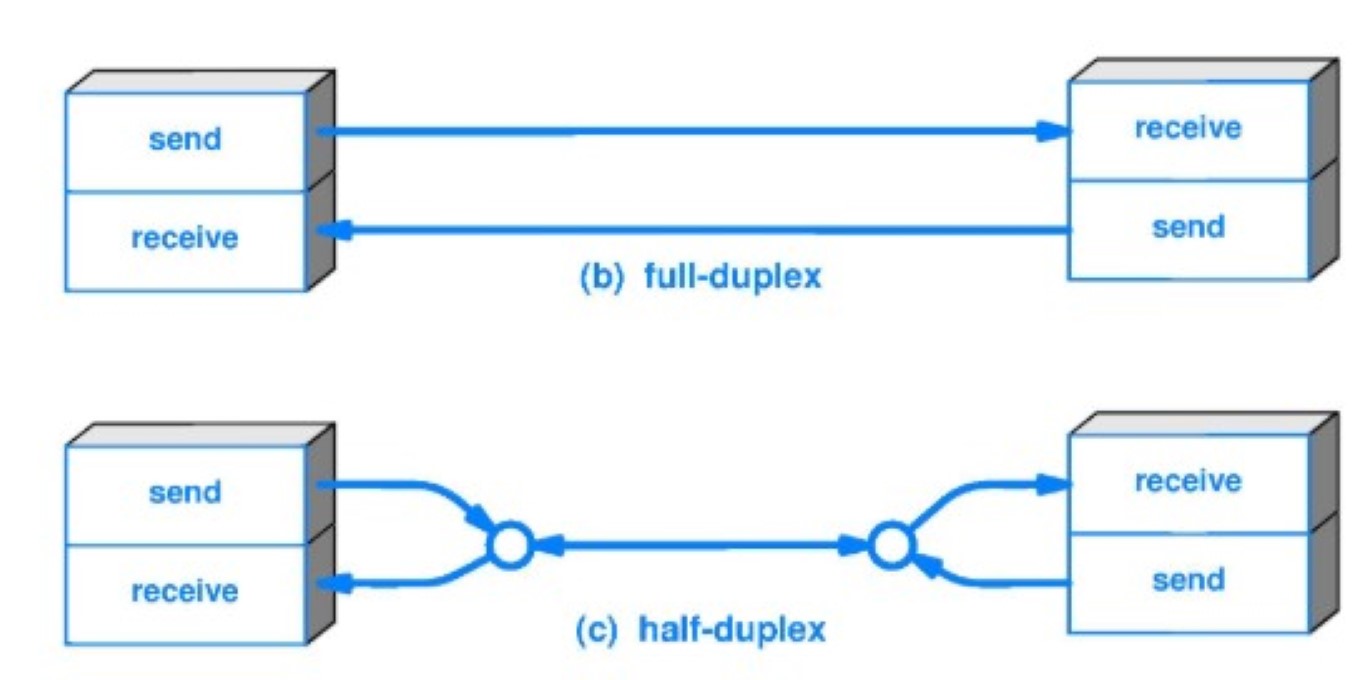

He'd need to allow half duplex for that to work.
the sys connector is TX, RX, G. So it's full duplex.
I tried a few months ago to put a diode on the tx pin so it wouldn't receive the messages from inverted s.port, but it didn't work.
Posts: 13060
in theory it can be used. S.PORT is always running in half duplex mode. But wiring must be correct. VCC can't be connected there.
