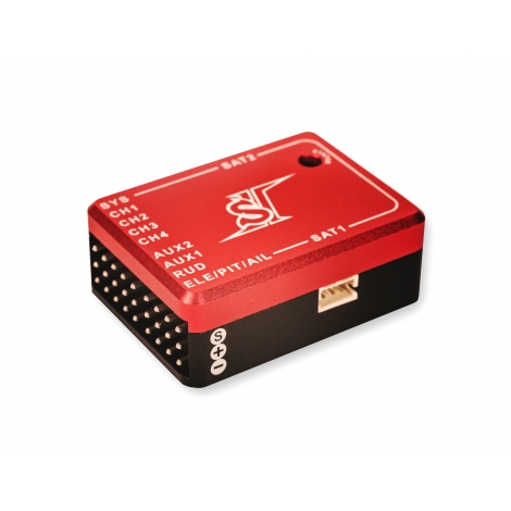

Hi Folks,
I downloaded the manual of the Spirit2 but it only shows different Spirit models. So no image of the POLARITY of the Spirit 2 :-(. Not even an image.
As the developers not even care to update their documents could anybody please tell me if the yellow pin is on top or bottom.
Galuwen
10x
Posts: 194
RTFM....
Taken from the manual....
3.3 Spirit 2
All cables connected to the unit must be oriented so that the signal wire (ORANGE wire) is at the top of the unit. This orients the negative (BROWN wire) at the bottom of the unit.

Galuwen
Posts: 9
Joined: Sat 06. Jun 2020 23:58:53
:lol: :lol: :lol:
You are right!! Thx a lot folks.
