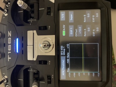

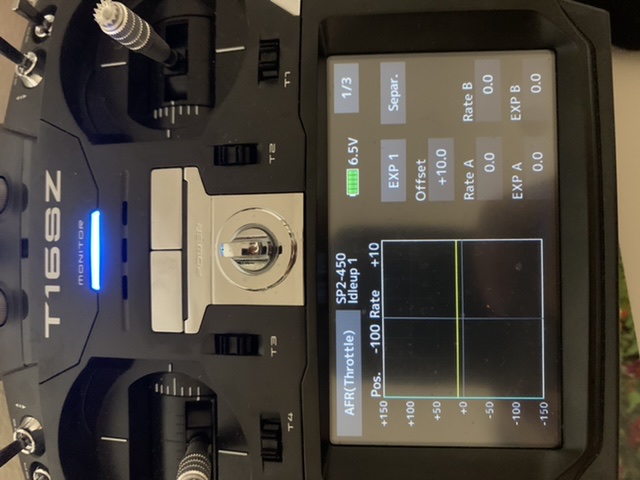

On T16SZ, I use the „idleup1“ mode to set the flat throttle curve.
On The „Normal“ mode, when the throttle reach middle positions (50%), the rotor rpm is about 2500 rpm (I use additional Futaba SBS01RM, same rpm)

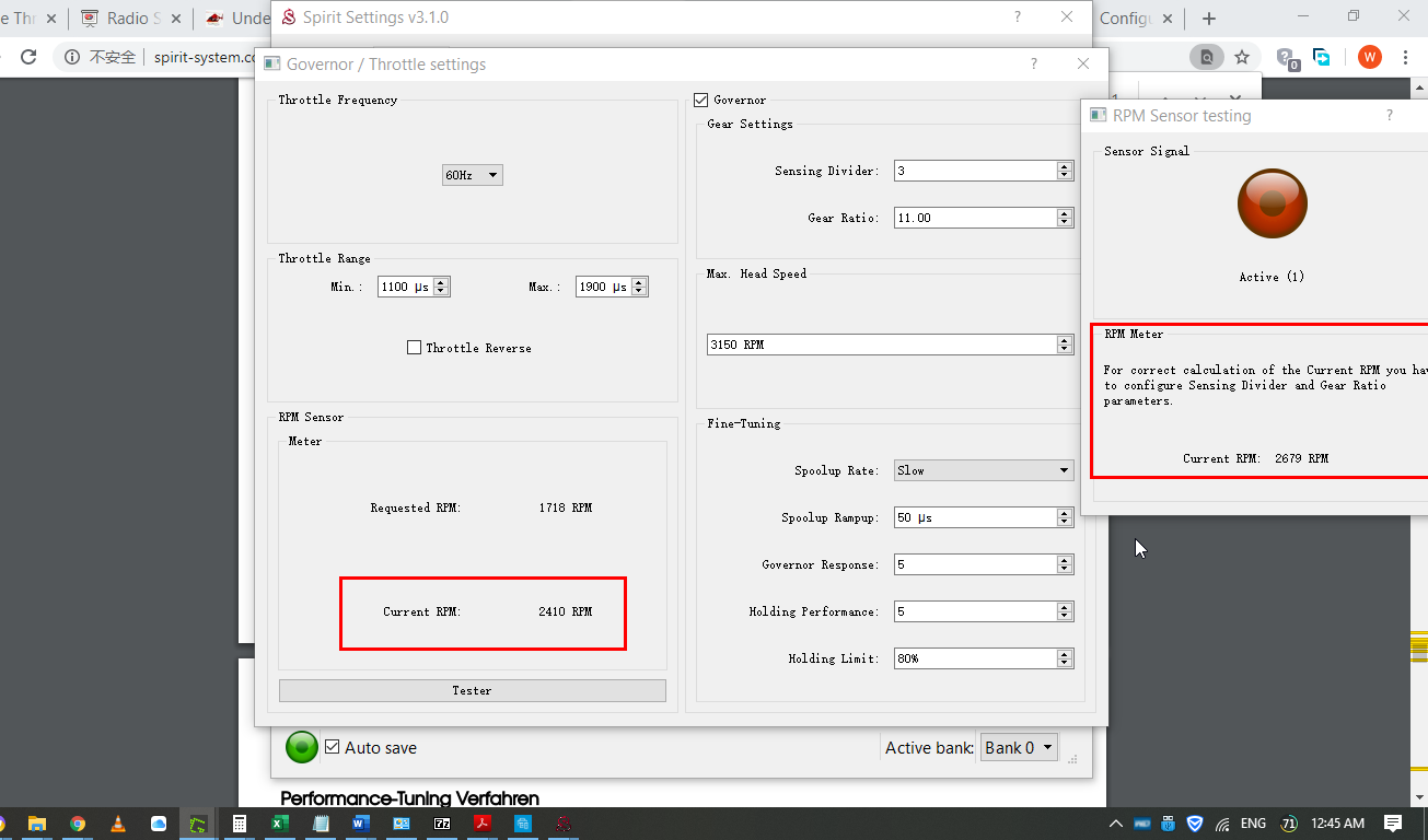

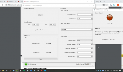

I „think“ the governor does not work at all :-(
The rpm ist not really stable, and the „current rpm = 2410 rpm „ is far away from „requested rpm =1718“
questions:
1. Are my settings on Spirit and T16SZ correct ?
2. how to set the „requested rpm“ ? I do not know where this „1718“ has been set and where it can be set? (Based on the value, I think it near to 3150 x 55% (T16SZ’s idleup 1 throttle setting = 55%)
Should I increase the „maximum head speed“ on Spirit to 5000??
3. why the „current rpm „ is much higher than „requested rpm „ ?

as in the screen shot above, the "SPIRIT Setting" the "current RPM could be read correctly. i suppose it works fine. and Spirit get the rpm data also correctly.
4. if the "requested rpm" 1718rpm = "max head speed " 3150rpm * "radio percentage" 55%
=> it means that if i need to get 2500 rpm as the expected Governor target speed , i need to set the "max head speed " to about 4545 ?
5. how do i know wether the SPIRIT Governor has take over the speed control or not?
(except for checking the if the speed is stable or not)
sorry, it is my first time using Governor feature. so asking a lot of simple questions. :-)

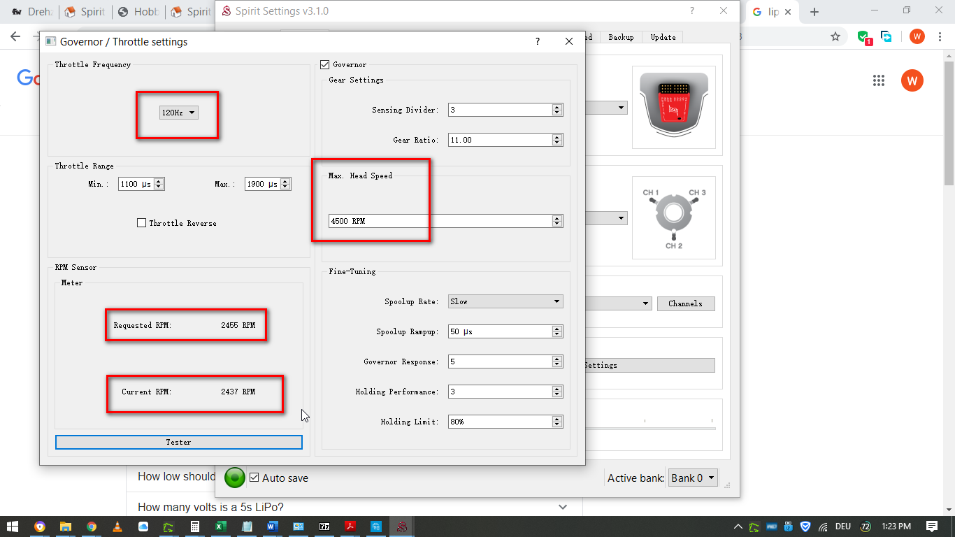

your reply speed like rocket! Amazing! thanks!
I try the 120Hz, the ESC&Motor runs ok, just do see the difference. :-)

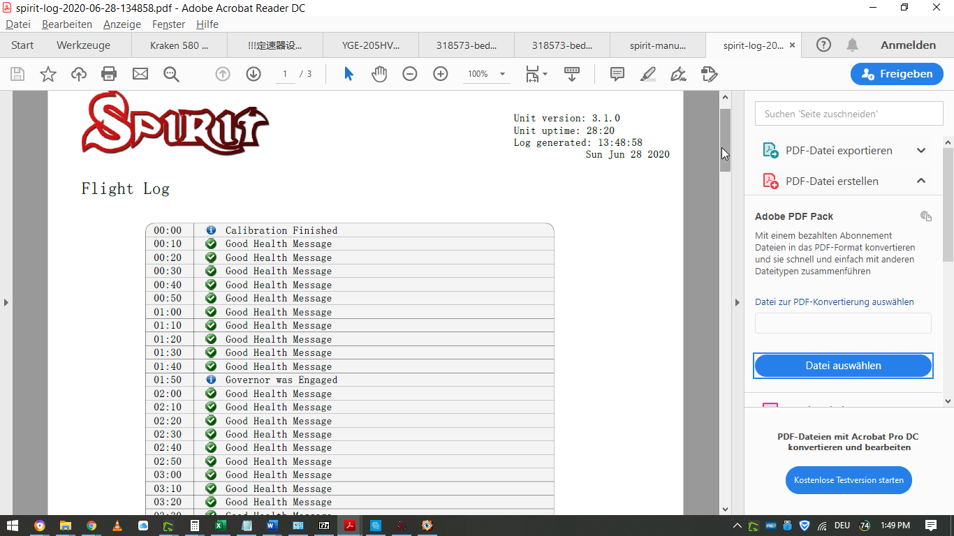

1. Governor works ??
I change the "max head speed" to 4500rpm, now the speed value match each other ("current" is near to "requested"). but i still do not know if this is the governor is activated or it is because the ESC control the motor speed according to the setting % from the radio ?
2. how to change the target speed setting for SPIRIT Governor?
but if i change the radio throttle flat line level to 60%, means that the SPIRIT governor will works with the new value 4500*60%=2700rpm ? but how the SPIRIT know my "expected speed" setting change, i do not see any "Target Speed Value" or similar setting possibility in the "SPIRIT Setting" App.
or the Governor take the flat cure % as the target value and try to keep the motor run stable at the target speed value?
