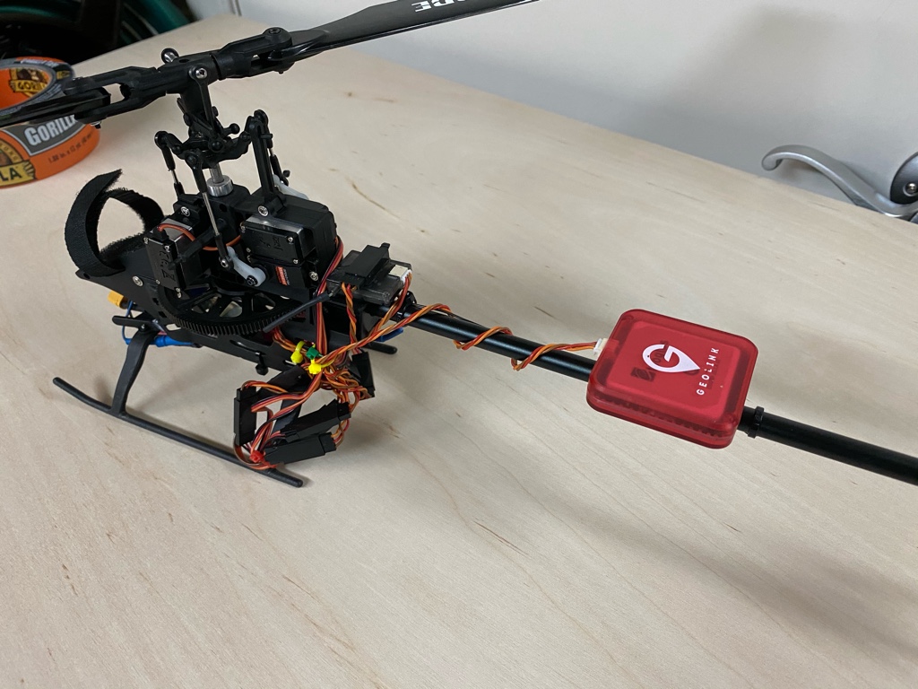

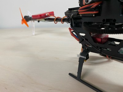

jjuk wrote:
You have a geolink on the 230s? The geolink is massive. Where did you put it? Photo?[/quote]
It’s on the tail boom and it all fits with the uSPIRIT. I could have optimized the wiring, I left all the adapters and the long wires.
It fly’s heavy but it has the RTH and rescue. Great to learn and rescue from crash.
Here are pictures
Envoyé de mon iPhone en utilisant Tapatalk
jjuk
Posts: 305
Joined: Thu 05. Oct 2017 20:06:35
Yeah I see. All the adaptors is the reason my 250cfx's don't have have uSpirits. You save a few mm with the spirit but then need to find space for 5 adaptor cables.
I'm wondering if the S2 would fit; the bird is slightly nose heavy already with a 1500mah 3s, so may balance it out.
But then the S2 doesnt have motor tail software.
