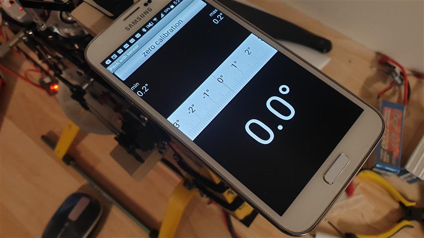

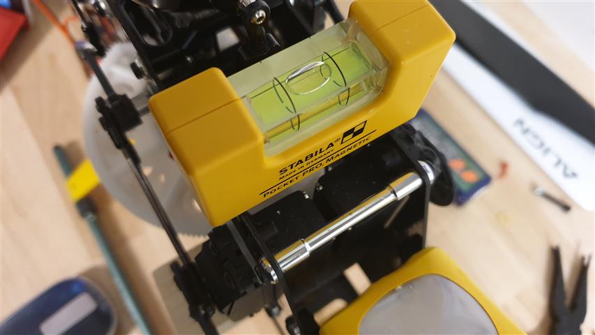

I started working on the Coaxial setup, but decided to check everything again before this. I did NOT like my findings:
1) My control rods - Ail / Pitch are both exacly 30mm in length between the plastic connectors
2) Swahplate is leveled
3) I am using one blade as refrence, set mid stick - have zero on a spirit level on the frame and on the blade. Also have zero on the pitch gauge app - the blade I am checking is to the front of the heli.
4) I turn the rotor around so that the 2nd blade is at the front. Pitch gauge shows +2.1 degrees
5) Both control horns to the DFC arms are same length. They are both screwed all the way IN, so I will have to unscrew the one I am using as Reference out - to make it also +2.1 degrees
6) Then, re-center the whole swashplate downwards to get Zero at mid stick.
Is my thinking correct?
How can the two DFC arms need to be so different in length?
For the initial checking the 6 degrees, should I check on the blade positioned over the tail or the one pointing forward?
Going mad...
