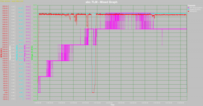

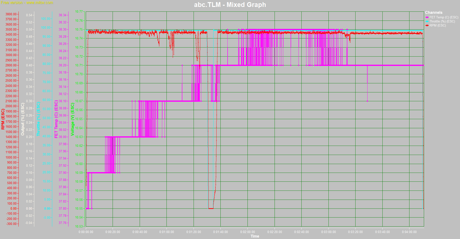

I do have a problem, that some channels of the Hobbywing Telemtry are not transferred correctly. In my case the FEt temperature, which is even after 4min flight just around 38deg Celsius.
Spirit_SRXL2_FET_TEMP.csv
(133.28 KiB) Downloaded 126 times

The FET temperature cannot be 38deg during all 4min flight. It should start somwhere ambient temperature, but even this is not the case.
For me it looks there is wrong mapping, because on other FBL such as Brain I have correct temperature, using same Hobbywing ESC and SRXL2 protocoll
