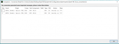

Converting the sample Horus X12 OTX settings file in Companion to my radio profile (Horus X10S) yields two conversion errors. I'm relatively new to OpenTX so any help understanding how to correct these conversion errors would be appreciated.

You just need to confirm that the X12 left and right sliders LS and RS are assigned to the X10 sliders LS and RS in the mixes for CH8 and CH9.

Got it, thank you.
