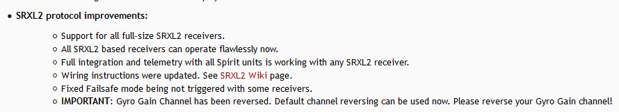

I got an new Spirit2 some days ago and I want to take the SPM4651T (SRXL2 satellite receiver) to setup the FBL - I have an question about the gyro-channel-reverse, that was said in the News about the new firmware 3.10 - by the way the FBL has this actual firmware - What I don't understand is, that I shall reverse the gyro-channel, because in the diagnostic-tab the gyro-channel works for -100 as rate mode and from 0 - 100 as headinghold-mode, I have not reversed the gyro-channel till yet. I think if I see in the diagnostic-tab the right information it shoult work ? In which cases is the channel-reverse necessary, only from upgrade from fimware below 3.10 ?

no reverse is needed with 3.1.0. With previous version it was needed.
So as you can see in the ChangeLog if you are using default settings in your radio, it will work.
