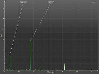

I have a major issue with the rescue function:
If I activate the rescue(normal) mode while hovering the heli moves up in an angle/sideways instead. I tried it several times.
Since I already read some posts about similar issues I did some tests:
1) I removed the main blades and kept the tail blades mounted. Heli was placed on the carpet.
2) I activated the rescue mode right after initialization. The swashplate moved up straight without any visible angle.

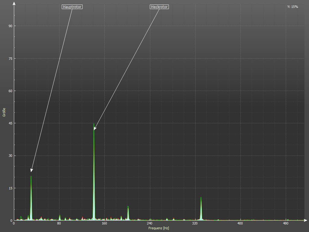

3) I started the motor. ~1900 rpm on main rotor. The vibration analysis displayed no strong vibrations (max. 45% in y-axis, see attachment). Then I stopped the motor.
4) I then activated the rescue mode again. => But then, the swashplate was strongly tilted and never levelled back.
This behavior is always reproducable. Sometimes the swash moves 2 times as it would do during a real rescue action?!, but never straight up as expected.
(Also nothing special in the log file: Sometimes 'Cyclic Ring' messages)
If there is no strong vibration, what could cause the rescue misalignment?
Thank you!

No, there is no cable or sth. else touching the unit, I checked it beforehand.
It seems to be better now. I'll try it while hovering tomorrow.
Additionally, I realized that I have stronger vibrations (75% on y-axis) if I attach the battery. For testing it was laying aside.
Maybe I can get the in-flight vibration log working until tomorrow to see how it looks like during flight.
One more thing I realized:
Right after initialization, if I set maximum pitch and activate rescue afterwards, the swashplate tilts to the left.
This would also explain why the heli is rescued in an angle......
