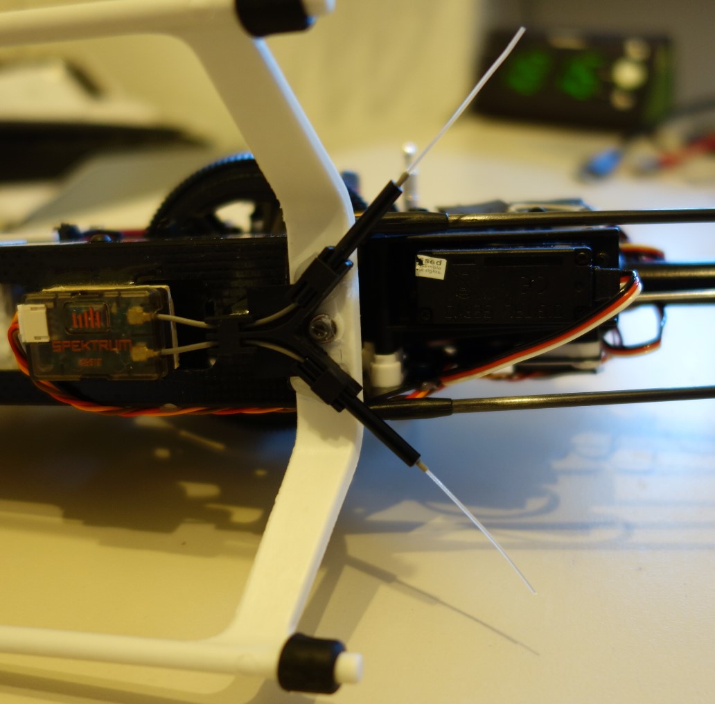

I have set up an Trex 450L with Spirit II and an SRXL2-Receiver SPM4651T. I have an question about the signal strength of my Setup (Spektrum DX18 Gen1 and SRXL2-Receiver SPM4651T). All funktions are working like it should but I have an question about the displayed signal strenth of my DX18 Gen1 - here I am very unsure if that is an problem - In the Display of my DX18 Gen1 I see an signal strength of -22dBm, and here is the heli and receiver placed in an distance of only 0,5m. No matter how the heli is placed obove/below front or behind the displayed signal strength is not more than -22dBm - I have an Blade-Heli 230S V02 and there I get an signal strength of 0 dBm (max) like it should be - What is wrong with my configuration ? Is the SRXL2-Receiver SPM4651T possibly defective ? The firmware of the SPM4651T is the newest 2.40 -

i have used the single 4651T on a Logo 400SE - so a bigger heli than your Rex 450... it's a 'real' 470/480. i had the Rx & antennas mounted very similar to yours, just a little bit higher (Logo 400 lower Gyro platform, ~ where your tail servo is). no problem with the Logos plastic frame.

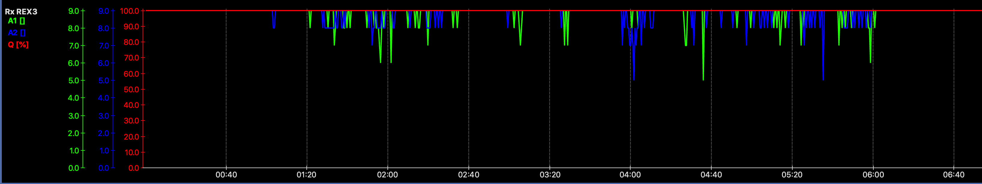

i've attached a signal quality log of the same heli (red=signal quality, A1/A2 are the 2 antennas - 9 being max), nothing else changed, just Jeti Rex3 (again 1:1 same position of antennas) as a receiver. of course this cannot be compared 1:1... we do not know how Jeti is calculating the signal strength plots. but i guess the result is clear... the same on all of my helis... including Diabolo 700... only 1 Rex3 and all logs look the same for antenna quality.

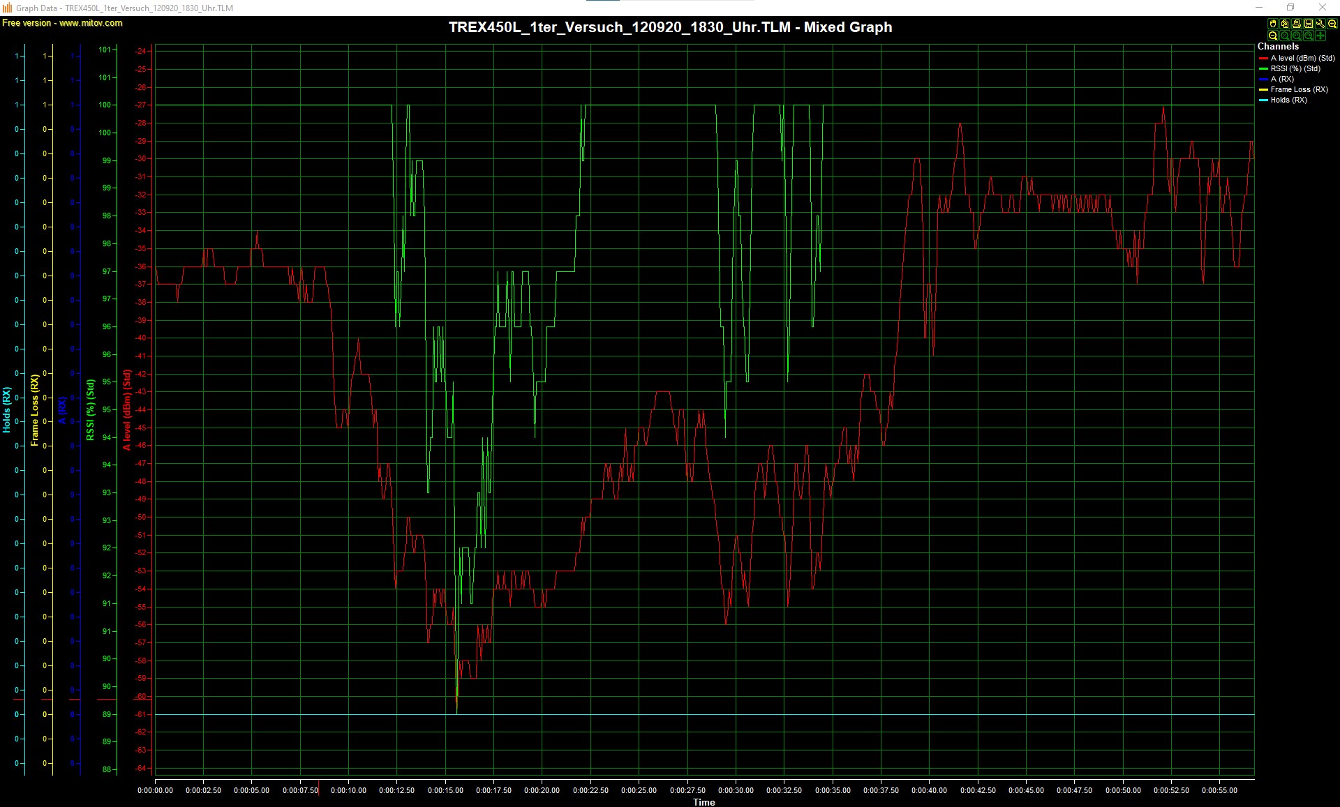

Today I have trusted me to make an "Range-Check" in the air with my TREX 450L with SpiritII and new configuration with SRXL2-Receiver SPM4651T...
In my DX18 Gen1 I have programmed warnigs for signal level at -61dBm and Framelosses greater than 20 -
With a little palpitation, I took off...and the tail of the helicopter was directed to me. I was about 5 m away than I got a warning of the signal level below -61dBm ! I was really surprised and landed immediately. I checked my radio but there was no Fade, no Frameloss and no Hold - I looked in the TLM-File and there I saw that the signal level was really under -61 dBm, but as discribed no frameloss and no hold.. In the flightlog I set the warning level of signal strength to -85 dBm and the framelosses as described greater than 20 -

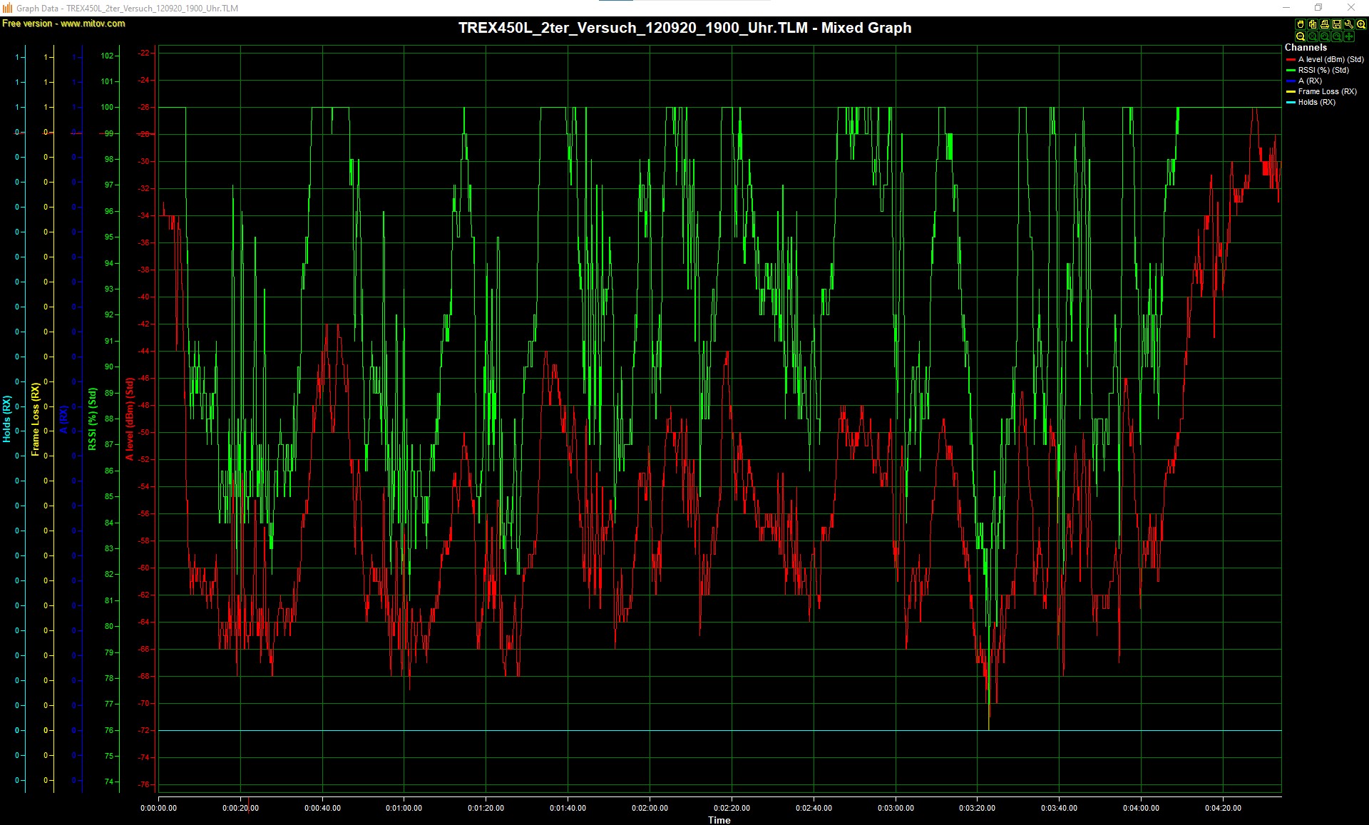

Then I made an second flight also with a little palpitation - I got no warning about the signal level again - I made some pirouettes, fly farther away and higher also with pirouettes.
After, I did not know exactly, about 5 Min I landed without any warnings. After that I looked in the TLM-File and here are no Fades, no Framelosses and no Holds - The signal level swayed quite strong in numerical value (-dBm), look in the added files -
What I have learned from this is, that the signal level does not seem to play a major role, at least with Spektrum, since I have not seen any fades, frame losses or holds in my remote control or in the TLM file. I assume that as long as I have got none excessive framelosses my range is absolutely fine - what do you think about that conclusion ?
Enclosed the two Scrennshots (files) -

same conclusion i made... looks just like mine (above) did... i would have no problems to fly like this. i had set my frame loss warning to 10 iirc... never reached it with this setup. even on my bigger helis where i've used AR7700 + additional sat i've only once scratched the warning threshold - the sat in the front of a 700 died... it was flying with main receiver only.
.. enjoy your heli! :)
