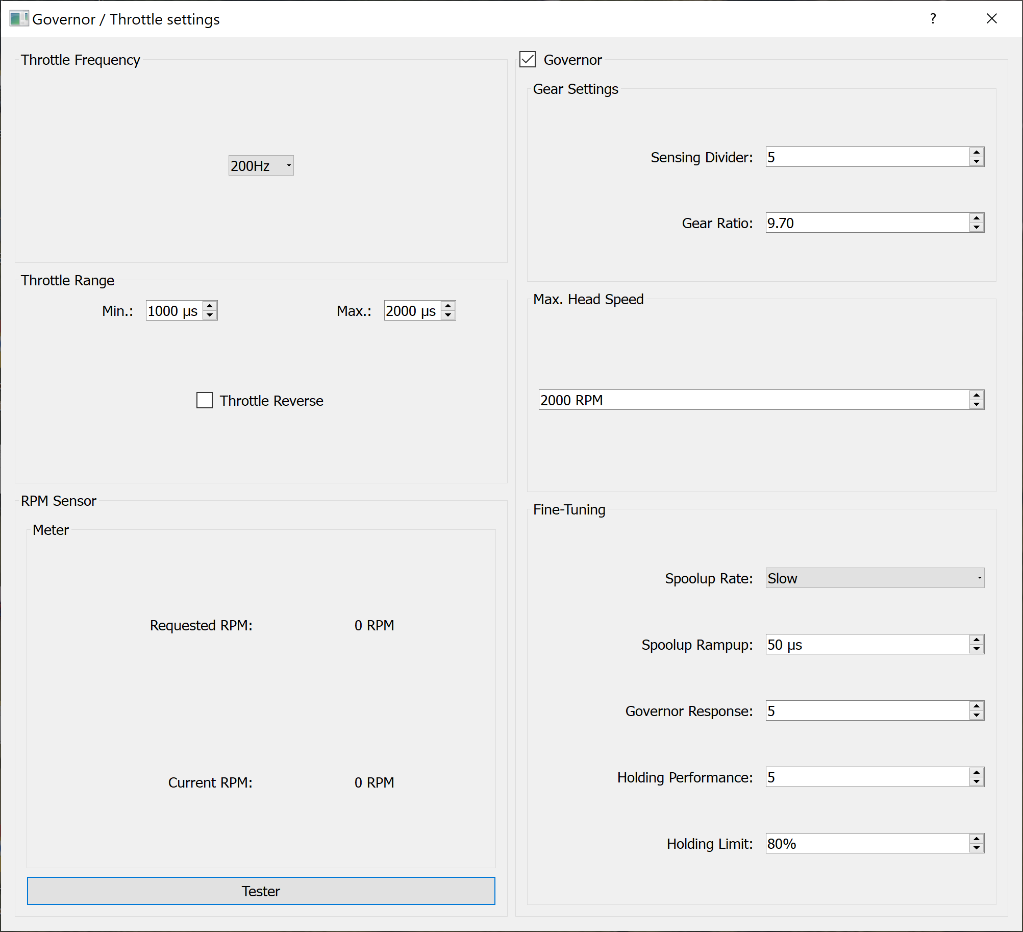

I've attached a screenshot of the relevant Governor settings page if it helps. Please note that early-on, I switched to the Spirit governor from the Castle governor because despite altering the ESC's settings, the initial spool-up included a big tail-kick which would rotate the heli about 90 degrees on the pad before take-off (!). This is why the 'spoolup rate' is set to 'slow'.

And yes, after checking the governor settings are the same for all banks.
I still can't understand why the Spirit unit sees such 'noise' on the rpm input. When I spool-up the heli on the bench the governor cuts-in and operates most times, but occasionally, I assume due to the 'intermittent/noisy' rpm feed, the governor doesn't 'latch' and the head will spin-up to over 2000 rpm, presumably the max headspeed for the setup / battery. In my limited experience of 'noise' pickup on wiring, I'd think of separating the white wire from the throttle-cable, but as its included in the flat molding of 4 wires (+/-, signal, RPM wire) I doubt if that will help. I've also double-checked the settings via Castle-link: the ESC is configured to 'Link Live Enables' and 'Auxiliary Wire Mode' set to 'RPM Out'.
