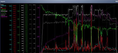

i guess this would be solved with implementation of what we've been discussing already some months ago: add Hobbywing (and other Escs) Esc's PWM% (the real power output % from Esc to motor) to the telemetry items. this is exactly the value you are searching... and it is the correct value wether you are using Esc's gov or Spirit's gov. for me too this is missing... it is the most important telemetry value (for me) during setup/tuning of a new drive train.
that's why i am still using jlog s32 with my Spirits... see example below: white: rotor rpms, grey: the PWM % needed, dark gray: Throttle % (linear, as i am using HW gov)
i am sure Tomas could add this easily in Spirit Esc telemetry...
telemetry example
telemetry example
