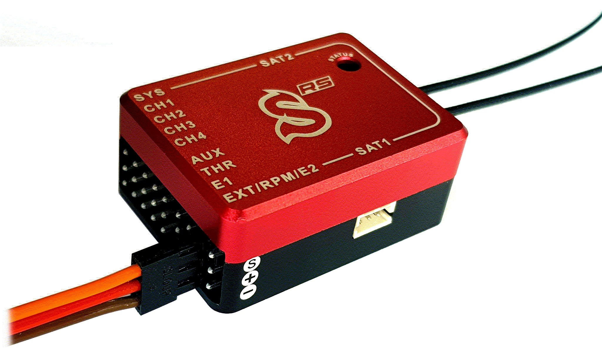

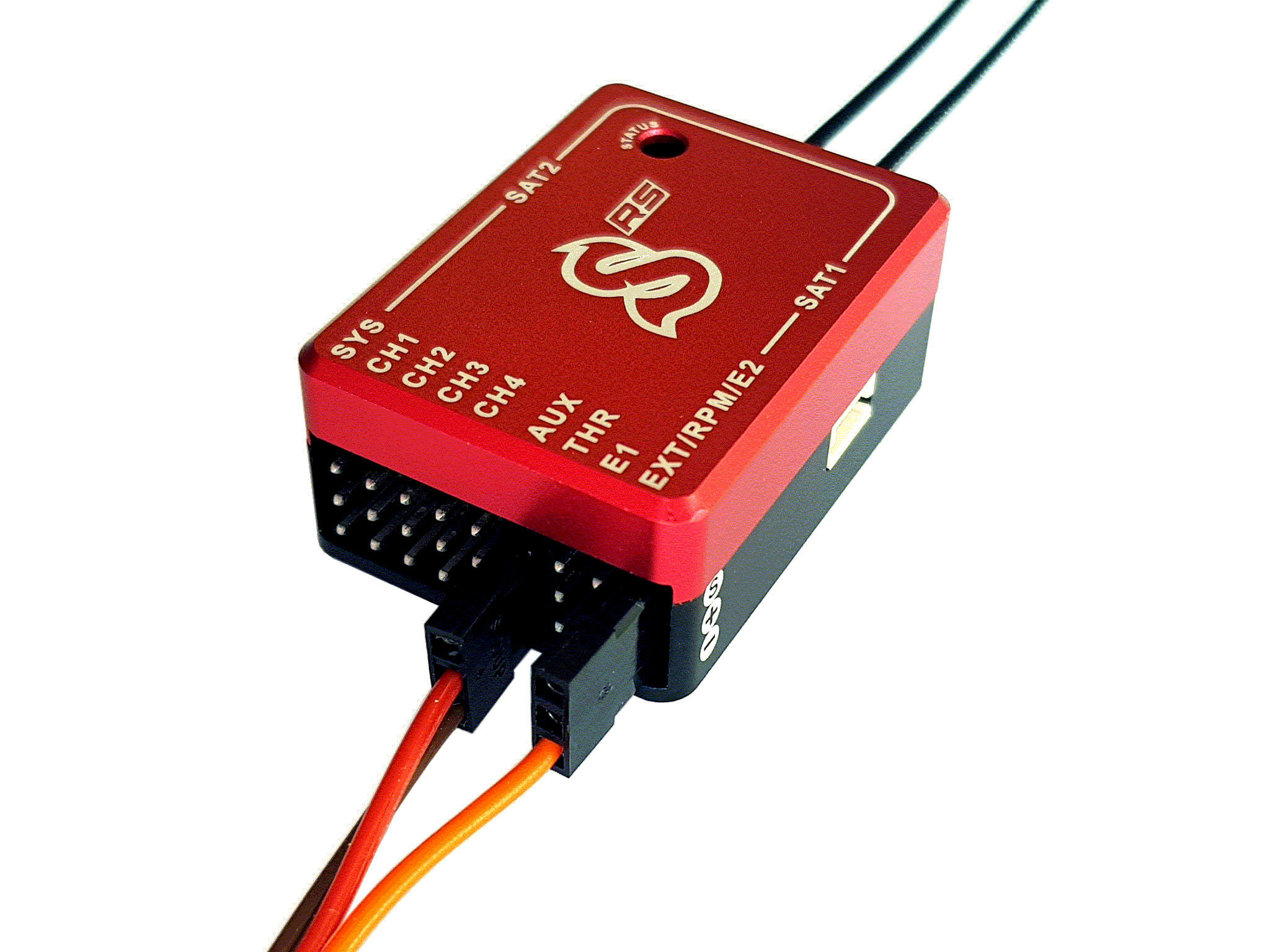

Ich weiß nicht, wie der Hobby-Wing Regler angeschlossen wird variante 1 oder variante 2 ?
Posts: 13054
Both are wrong unfortunately.
THR = Throttle - ESC connection
Yellow wire = RPM (middle pin) - this can be disconnected.
You can see description of the basic wiring here:
http://manual.spirit-system.com/index.p ... wer_Supply
It is same as at the attached photo of Spirit Pro unit, except there are different port labels. But positions are same.
