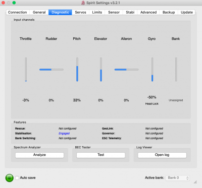

I've set up my Spirit on my Trex 450l following the manual and the wizard and it's doing everything I think it should.

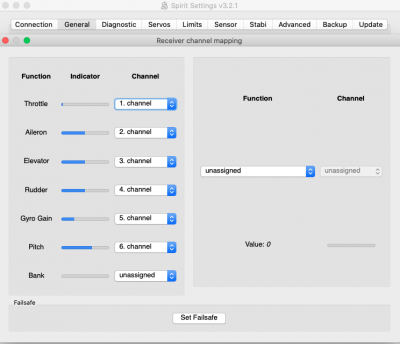

I've got Stabi on my 5th channel, but i'm unsure about this bit.
My question is where do i adjust my Gyro now? Do i still do it in the TX under Gyro? My plan is get that set right and then set that in the Spirit so I can free up that channel for Rescue..
The numbers in diagnosis don't match the numbers in my TX and this is confusing me too.

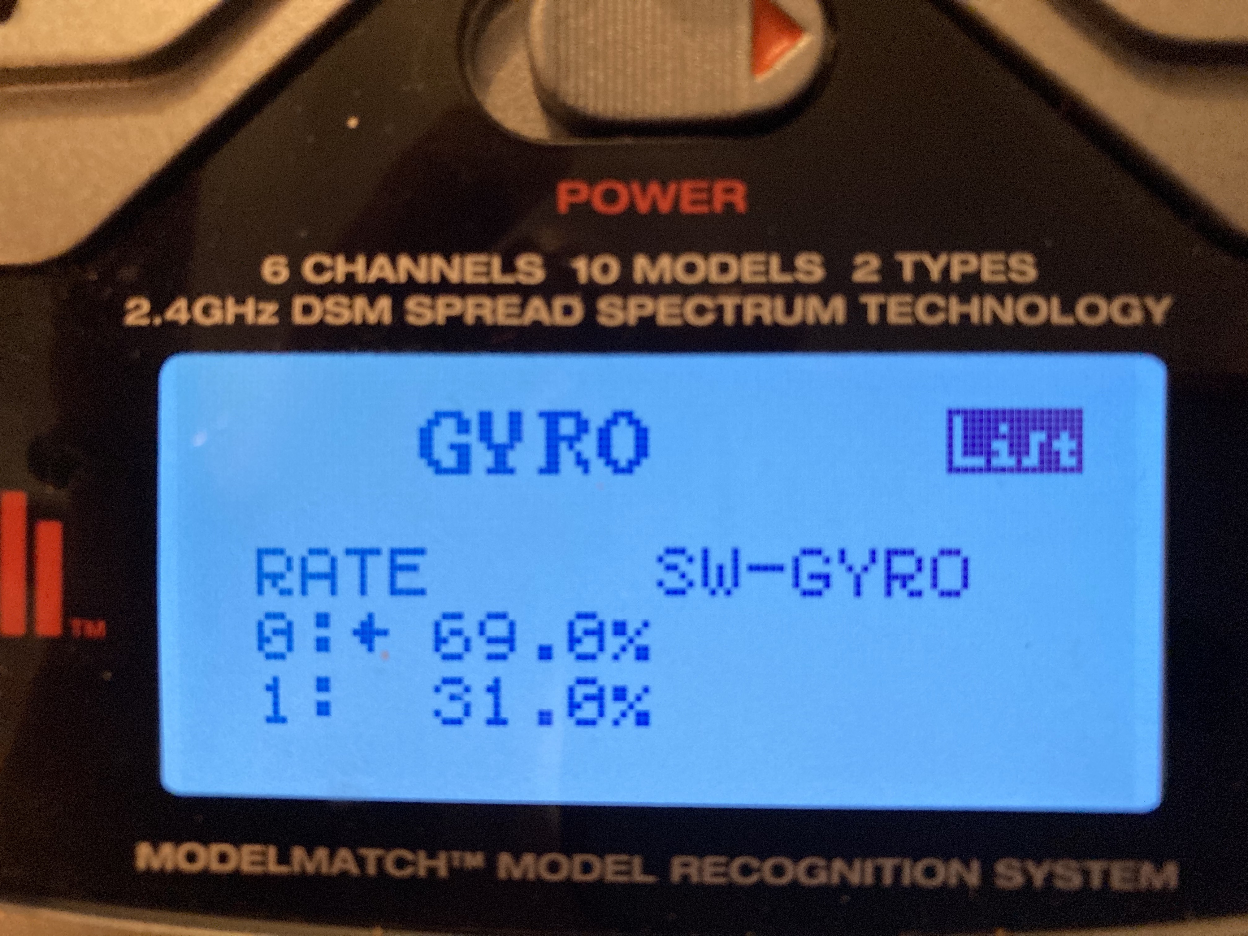

EG in TX GYRO = 69% in Spirit = -50%
TX GYRO = 315 in Spirit = +50%.
Hope that makes sense.

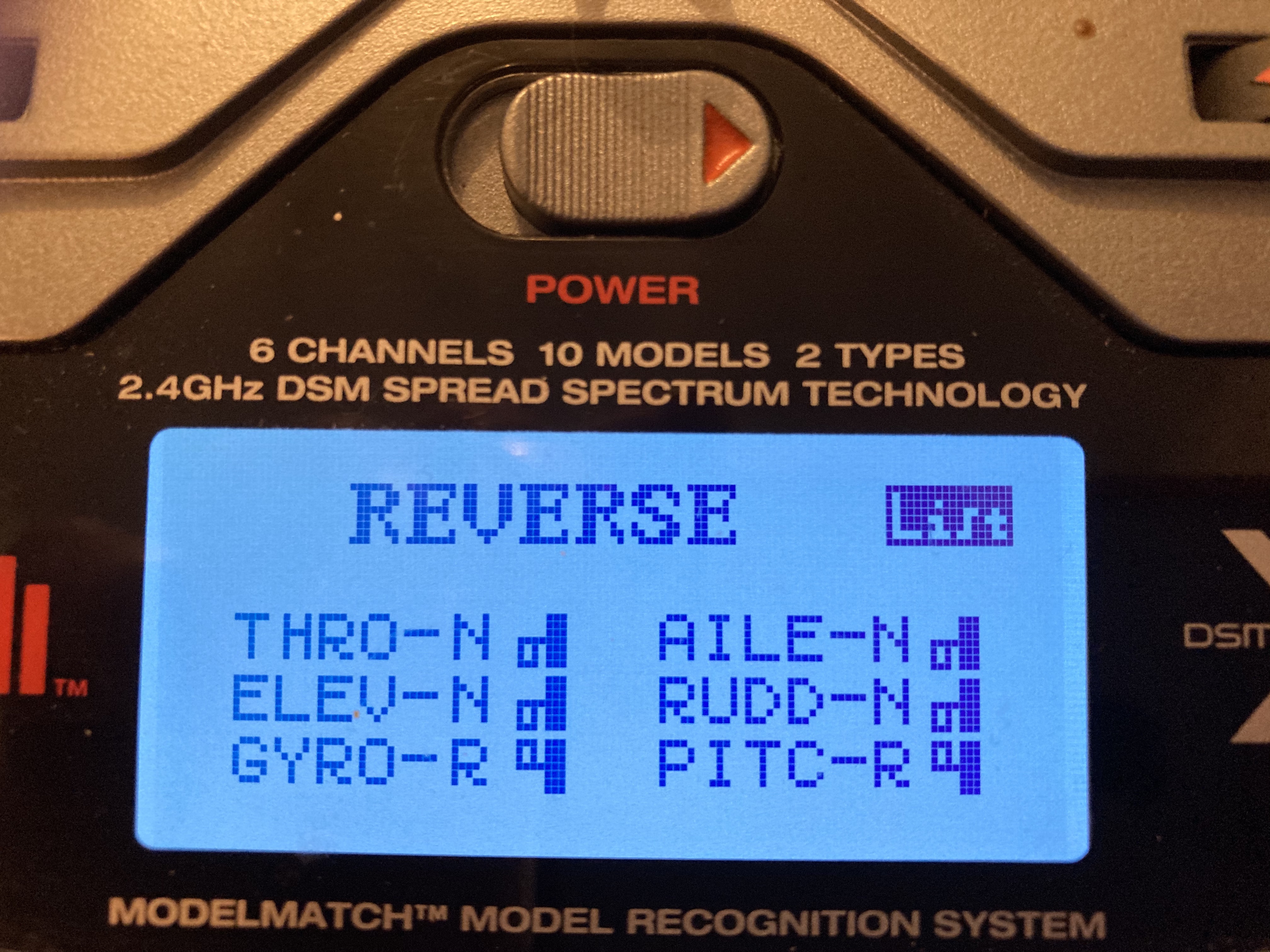

First you have to check that the gyrochannel 5 is not rev,increce the value in tx and look in general
tab that the numbers increces there to.Then you use a switch assign to a mix in tx and mix in a -number to the gyrochannel 5,so when you hit the resque switch the the gyro value
changes from + to -,that activates the resque in Spirit.

Ok my GYRO was reversed. I have changed that now. When i increase GYRO in the TX the number increases in the Diagnostic tab. When I have the GYRO at 31% in the TX it is -50 in the Diagnostic tab and the Stabilisation says Engaged.latjo-k wrote:HI

You have to solve the issue whith channel 5 gyro in tx maybe you have some subtrim or the end points not right -100 100 subtrim 0,and no mixing.Look in tx monitor that channel 5 moves from 0-100%.
Resque activeted depends on that you have a neg value in diagnostic tab gyro channel 5.
