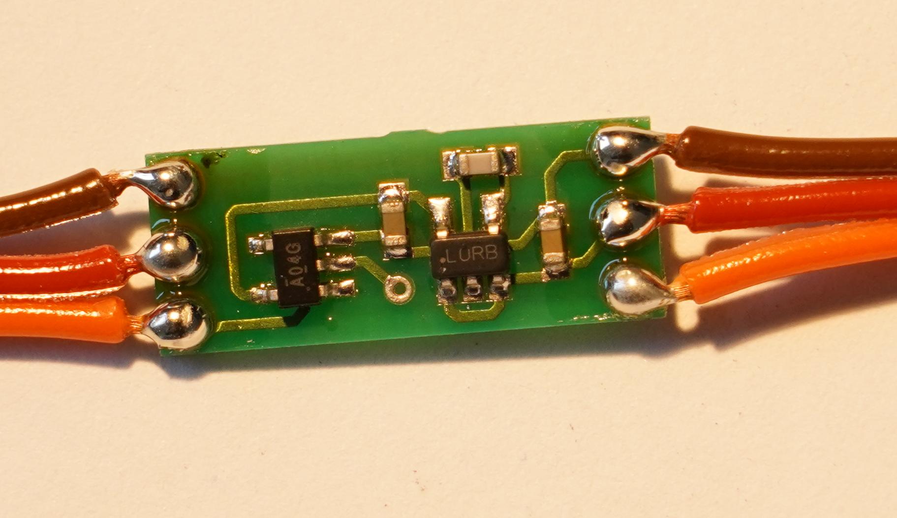

I made some further tests: I connected only the SBus adapter cable to a power supply, only + and - 5V, nothing else. The SBus adapter again became hot, and it drew 90mA - only the cable! I then removed the heat shrinking tube and found out, that the A04G is the part that is hot. I could not discover any obvious fault (soldering, ...) on the PCB (refer to attached photo).

Posts: 13059
The cable itself can be repaired if you can ship it to us, likely for free whatever was reason.
Normally it shouldnt be a problem even if connected in a wrong way. Only if cable was rotated in the port it might cause damage.
So it is really strange. Yes, there should be almost zero current.
