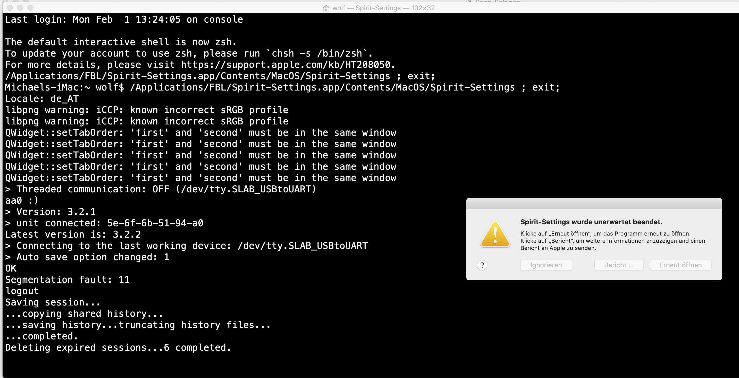

i've just installed newest macOS app Spirit Settings on my Mac... the app is starting as always as long as Spirit unit is not connected (interface connected, but Spirit not powered). as soon as i power up the Spirit the settings app ist crashing within 1-2 seconds after startup. i've manually launched the app from within the package => pls find attached the result and the macOS crashlog (first part)... maybe it helps. full crashlog available if necessary.

thank you for your report. The crashlog is helpful.
We are testing on Big Sur and High Sierra and it just works, even under Apple M1. Is the same problem happening also after installing 3.2.2 firmware?

yes - it is the same after unit was upgraded to 3.2.2... it crashes.
SiLabs driver is up to date for Catalina (CP210xVCPDriver (5.3.5)) and i've tested the old Spirit Settings 3.2.1 with the unit before upgrading it (under Windows) and it worked without problems!
