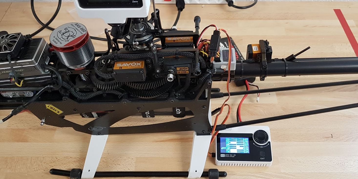

To monitor what's going on on SBUS I did add Monitor in parallel to RUD Connector.
I did configure Pitch on
RX Failsafe to max (1083us)
Spirit Failsafe to neutral (1500us) and
Radio input to minimum (1932us), to see what kicks in.
After turning system on. Everything works as expected. SBSU on Chanel 6 (Pitch) is moving with Stick input.
