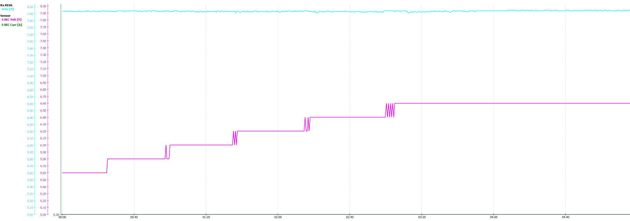

I was looking through the logs collected by the Jeti DS24 from the Spirit Pro, which in turn collects the data from a Jive Pro and saw that the BEC Voltage measured by the Jeti receiver is different from the BEC Voltage measured by the Jive. The one from the Jeti is correct.
Heli on the bench.
Voltage graph
Voltage graph

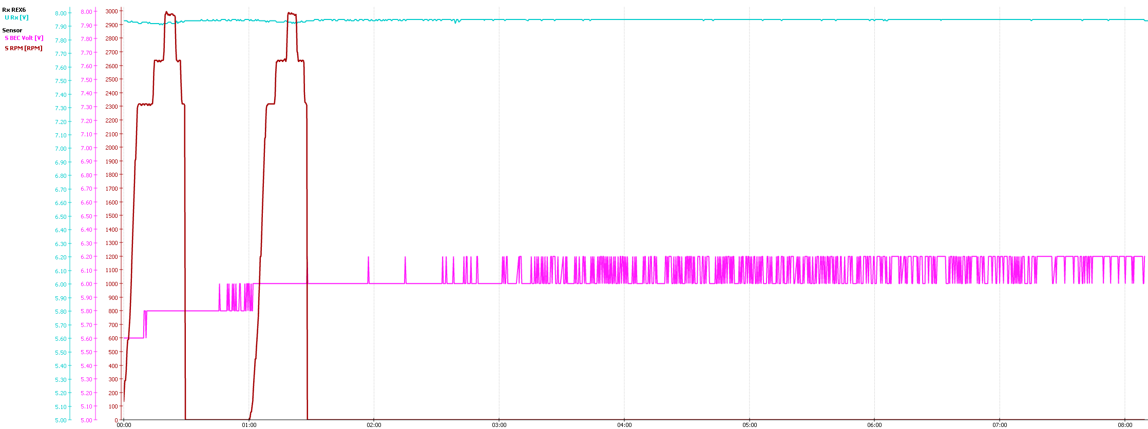

This is another log capture with RPM visibile, heli on the ground with blades installed.
So both logs show the same behaviour.

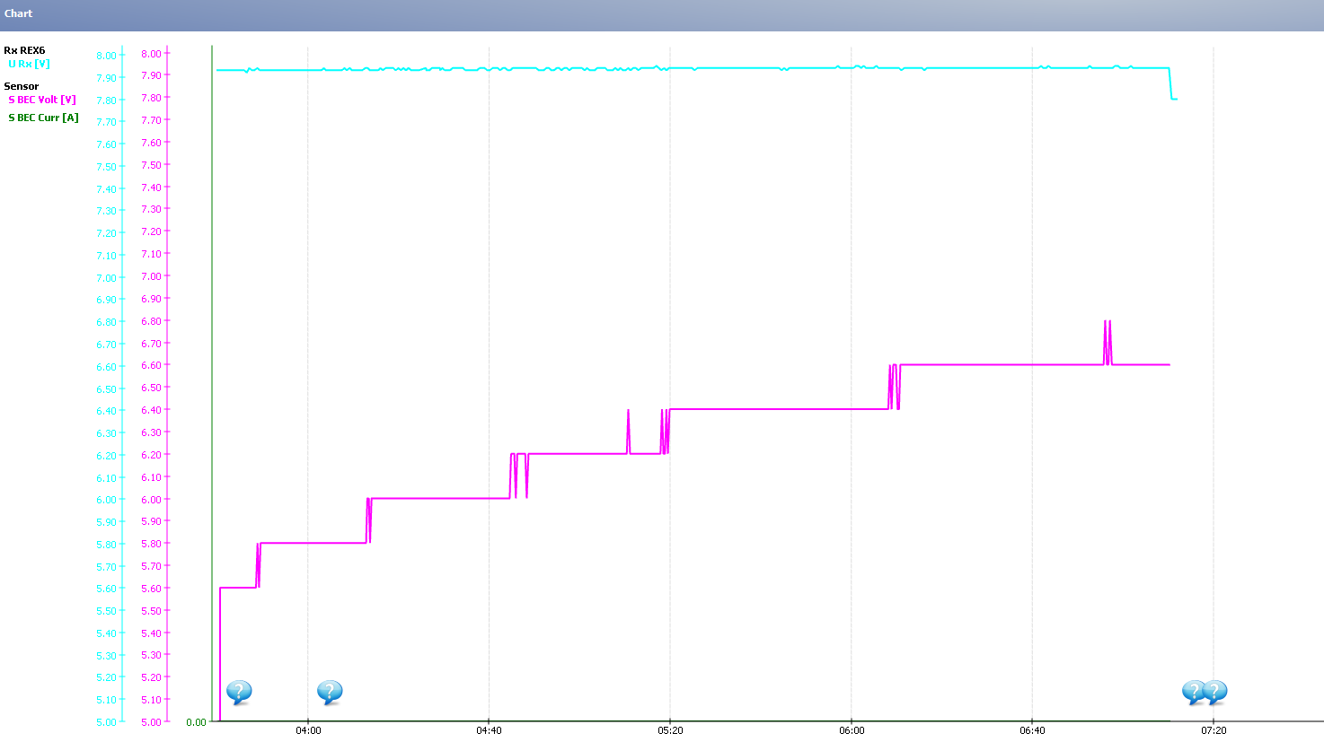

After looking at the graphs, it seems that the S Bec Volt chart, is in fact a wrongly mapped temperature reading. I've looked through several logs and the SBec Volt line is behaving like a temperature increase chart (of course, the value is incorrect).
Another example:
