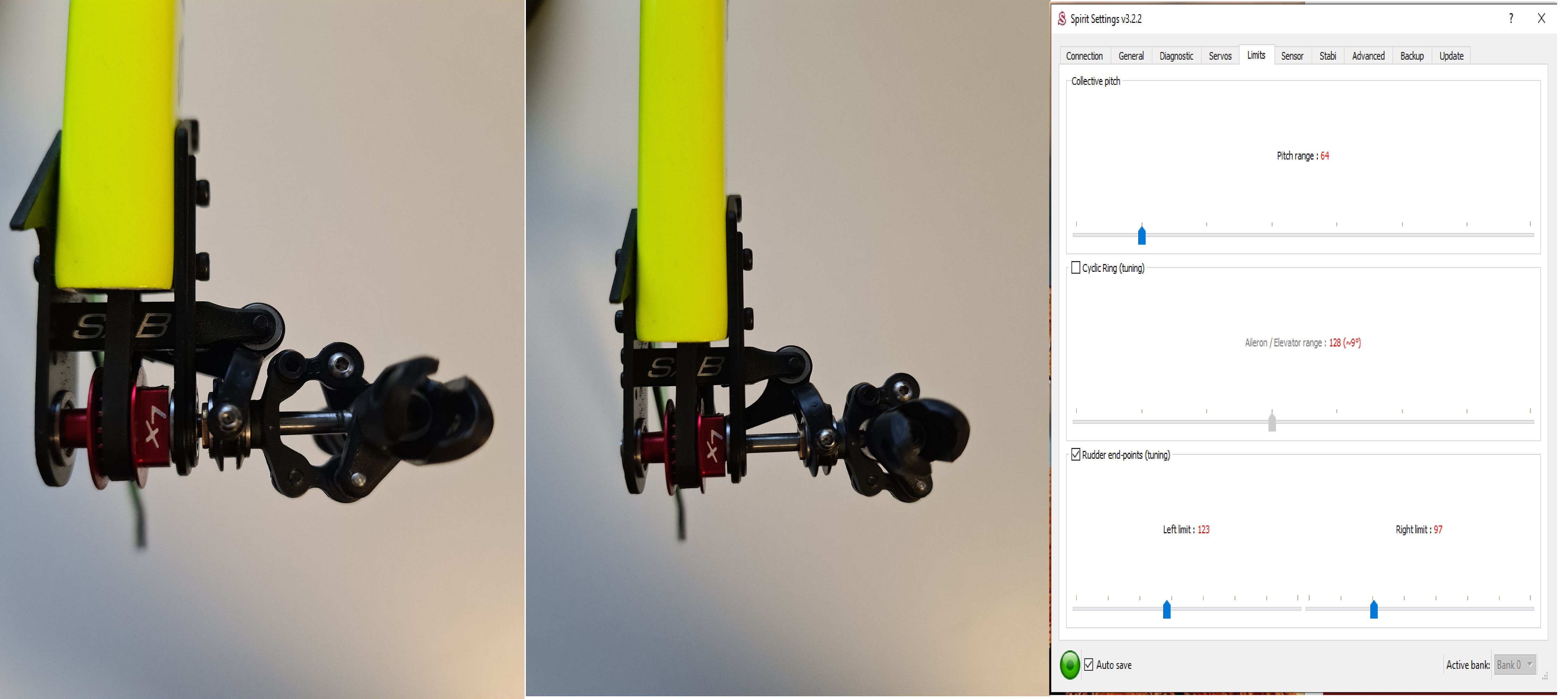

spirit software limits tab, tail is set to near the max mechanical way:
tail operated with the TX:
opentx servo monitor shows +-82.8, spirit diags show this as -+100.
also attached my opentx model for that heli, but it is nothing fancy:
