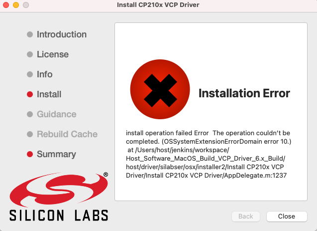

Upgraded from Spirit Settings 3.2.2 to 3.3.2-r2 after upgrading mac to Big Sur and now it does not connect anymore to unit Spirit2 via the USB programming cable. Have Mac OS Big Sur 11.5.2 build 20G95.
Have tried installing the CP210xVCP Driver for Big Sur but neither USB-driver 6.0.0 nor 6.0.1 installs correctly. Installation of the CP210xVCP Driver displays Error Message (see attached screen shots for 6.0.0 and 6.0.1 error messages). CP210xVCP Driver seems to be placed in the /Program Files folder but nothing in Library/Extentions folder and nothing in System/Library/Extentions folder. There is also no obstructed extention file to Allow access in Mac OS System Settings Personal Security Pane. Have tried Legacy Driver and the Trouble Shooting Driver too, both after uninstall and reboot without luck. Have tried to give the driver full disk access too but still not working. Have even tried to copy Library/Extentions/SiLabsUSBDriver.kext and Library/Extentions/SiLabsUSBDriver64.kext from another installation on a Mac with OS Catalina, but still no luck.

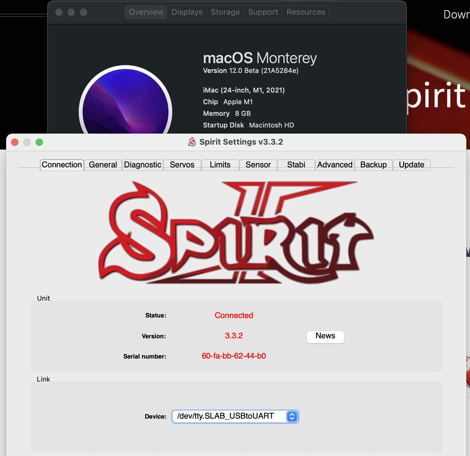

I uninstalled the original driver with the included "uninstall.sh" script, then rebooted the Mac - Important!
Now reinstall the driver using one directly from Silicon lab - https://www.silabs.com/developers/usb-t ... cp-drivers
Connect using Spirit-Settings and the result can be seen in the attached picture:)
Oh, and yes the driver is now stored in the Applications folder and NOT in the extensions one. I also bashed my head on that one for a bit before just uninstalling and trying again..

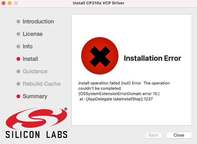

Tried first creating new admin-user-->Uninstall with 6.0.0-->reboot-->reinstall with 6.0.1, same error.
Tried secondly to activate root-user-->Logged in as root-->Uninstall with 6.0.0-->reboot-->reinstall with 6.0.1, same error.
Even tried to move installation file outside the image container, opened the package content and run the installer app in terminal as root user, but still same error...
Have no idea whats wrong...

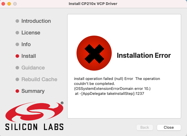

Here are the error messages attached:
