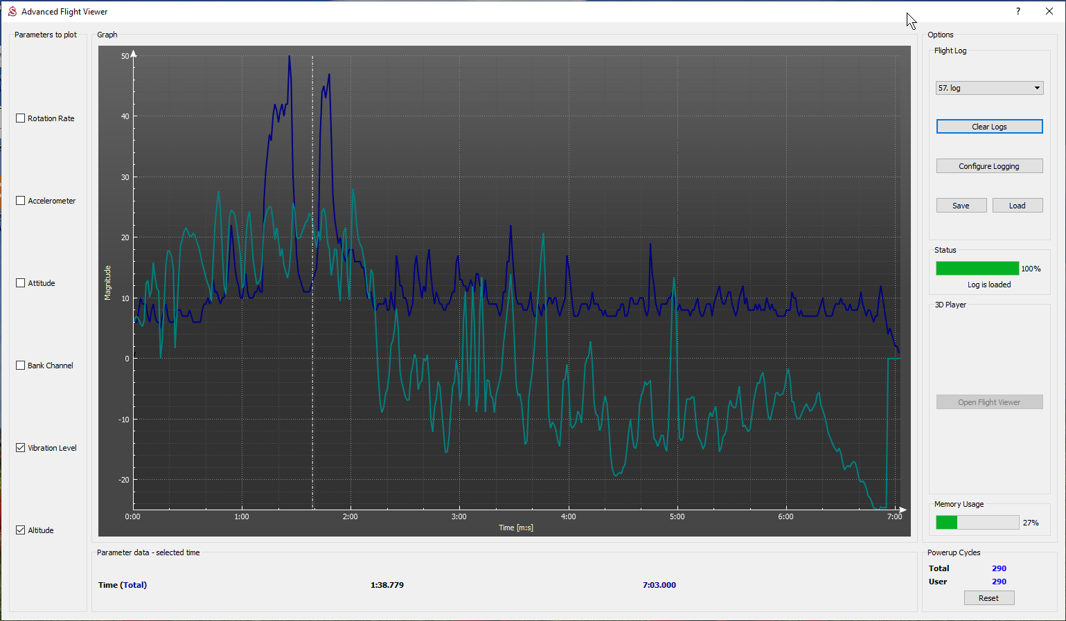

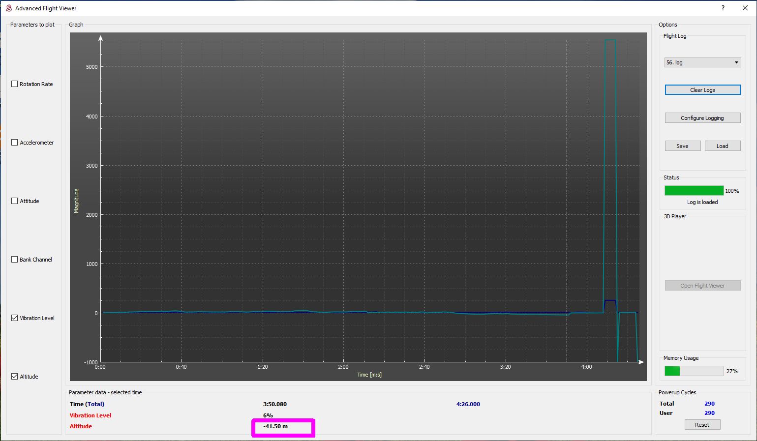

I have made several flights with my TDSF at various terrains and various rpms, but mostly at 1000rpm and the automatic resue function behaved well and the rescue trigger altitude remaind quite stable at what corresponds to the the configured altitude.
BUT, today I flew again my TDSF with 1000rmp and each time I decended into the trigger altitude of the auto resuce it increased that trigger level by about the value set in the sofware. So after 5 times it triggered at around 50 to 70m above ground. My logs are showing negative altitude values down to -46m. Today was a calm evening with very low wind. I had landed and recycled power. After take off the same behavior was abserved again.
I hope there will be a fix for this issue soon. In another thread about wrong altitude telemetry I read that it could be related to low vibration levels of the heli. My TDSF seems to be running fairly smooth.
Another reason/motivation for having the ability to set the automatic rescue altitude during flight: During the last two weeks I flew at different locations. One was at a small cliff like location. It would have been so cool to just set the auto rescue altitude around or even below eye level as there was plenty of air below.
Log files are also attached as zip file.
