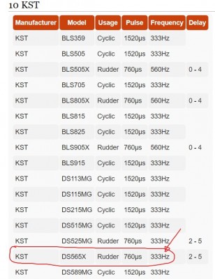

In the user manual, SERVO LIST section, model KST DS565X working frequency advised as 760us / 333Hz. However the actual product packaging shows 760us / 560Hz.
I had downloaded the specs sheet from KST site but they choose not to show the frequency in it. Only plus (760us) is showing.
I am wondering whether its okay to operate the DS565X on 333Hz. I haven't try it yet and would like to know your opinion first.
In the manual it is written correctly, because we were testing the servos.
It is better to use lower frequency if you flying very hard.

Thank you very much. I'll take 333Hz as the correct value.
