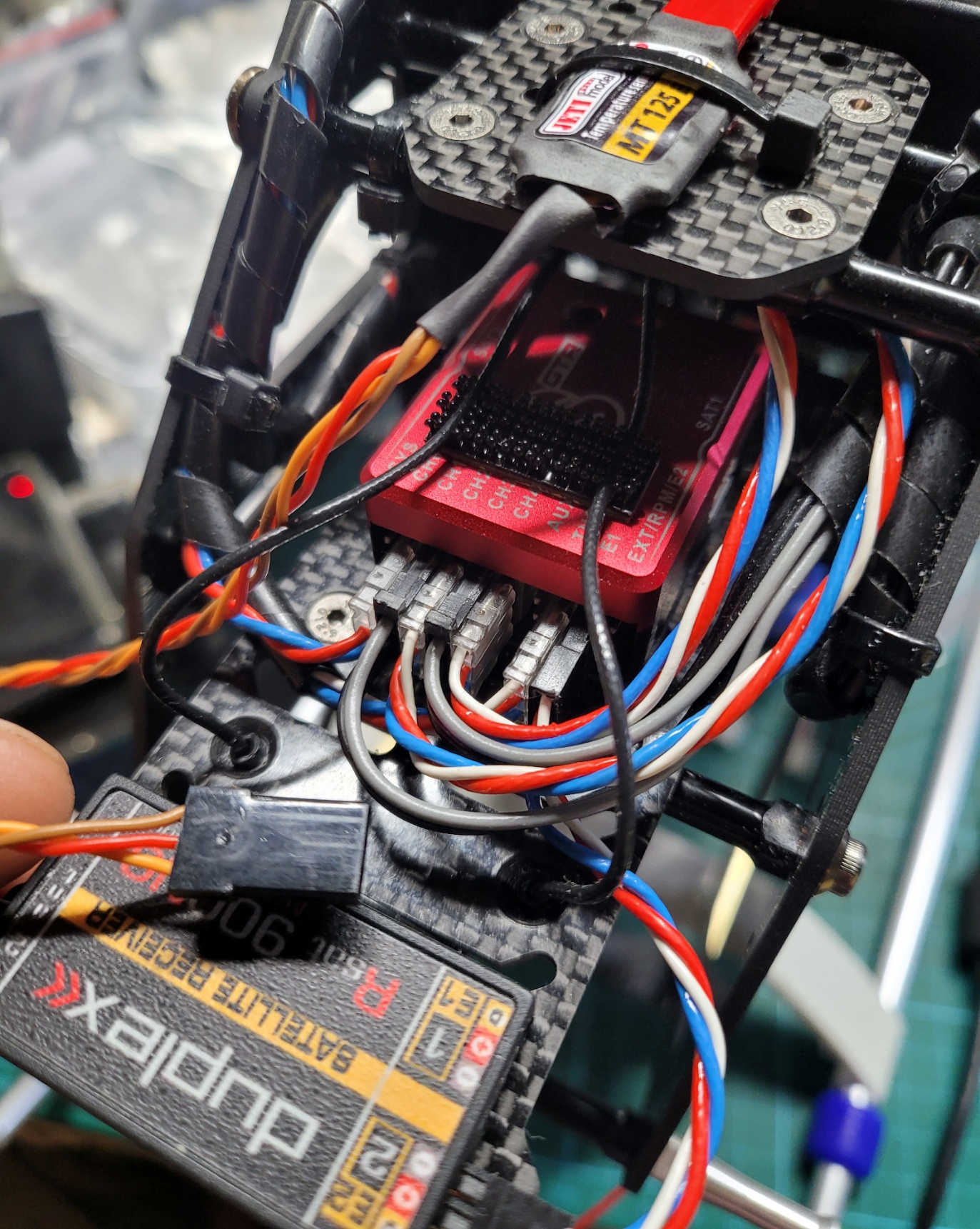

The E1 channel of my GTR is connected to the JETI 900NG backup receiver. I also have a JETI MT125 temperature sensor that I want to connect to GTR. How can I access it correctly?

you have to set E1 port in REX-RS to EXBUS first. Then the receiver should work.
Temperature sensor can be connected to the NG receiver or directly to Spirit unit.
But you have to use EXT pin. Please see this page:
http://manual.spirit-system.com/index.p ... y#EXT_port

ThanksZeXx86 wrote:Hello,
JETI does not seem to support the MT-125 temperature sensor module from the EXT port of Rsat 900 MHz NG.
I connected the MT-125 temperature detection module through "Connect Sensor or Expander cable in so that RED/BROWN wires are at the AUX port (or any other free powering port) and ORANGE wire at the EXT pin", and the DS16 remote control automatically detects To the MT-125 temperature detection module.
The JETI MT-125 module is connected to the EXT port of 900NG, and the E1 port of 900NG is connected to the E1 port of GTR.(Any port settings are invalid. But 900NG works fine. ) The remote control cannot detect the MT-125 module. Any input mode of REX3 settings made in the remote control is invalid.
Jeti + Spirit + Kontronik
JR Hirobo SAB QUEST VARIO
I am little bit confused, what is actually not working when temperature sensor is connected to Spirit unit?
