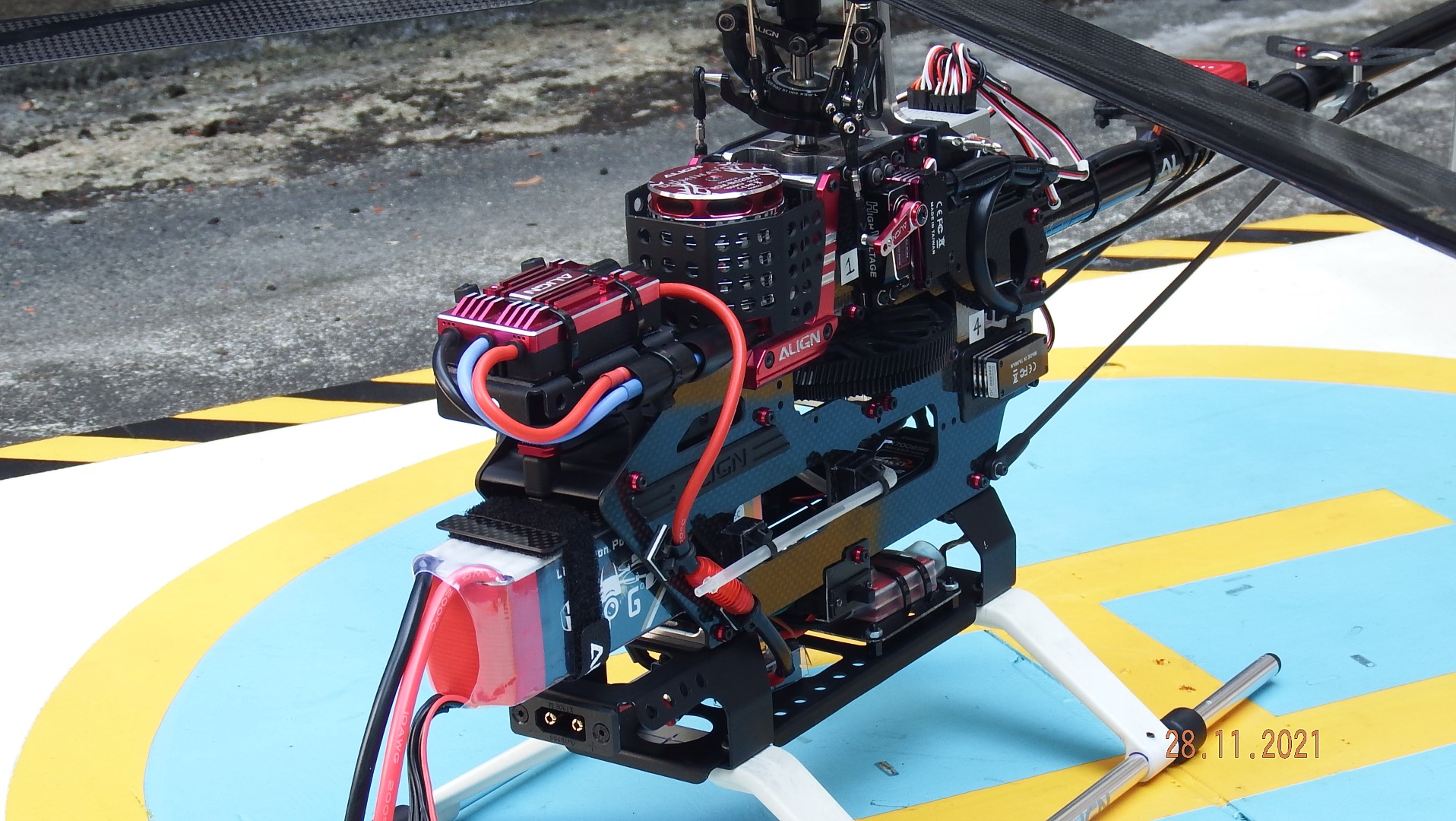

By the way, below are some photos of my bird. Please feel free to comment :D
Regards,
Amal
Posts: 12836
Very nice!
Connector is JST ZHR-3.
Yes, model must be in the air to see current draw and capacity.
