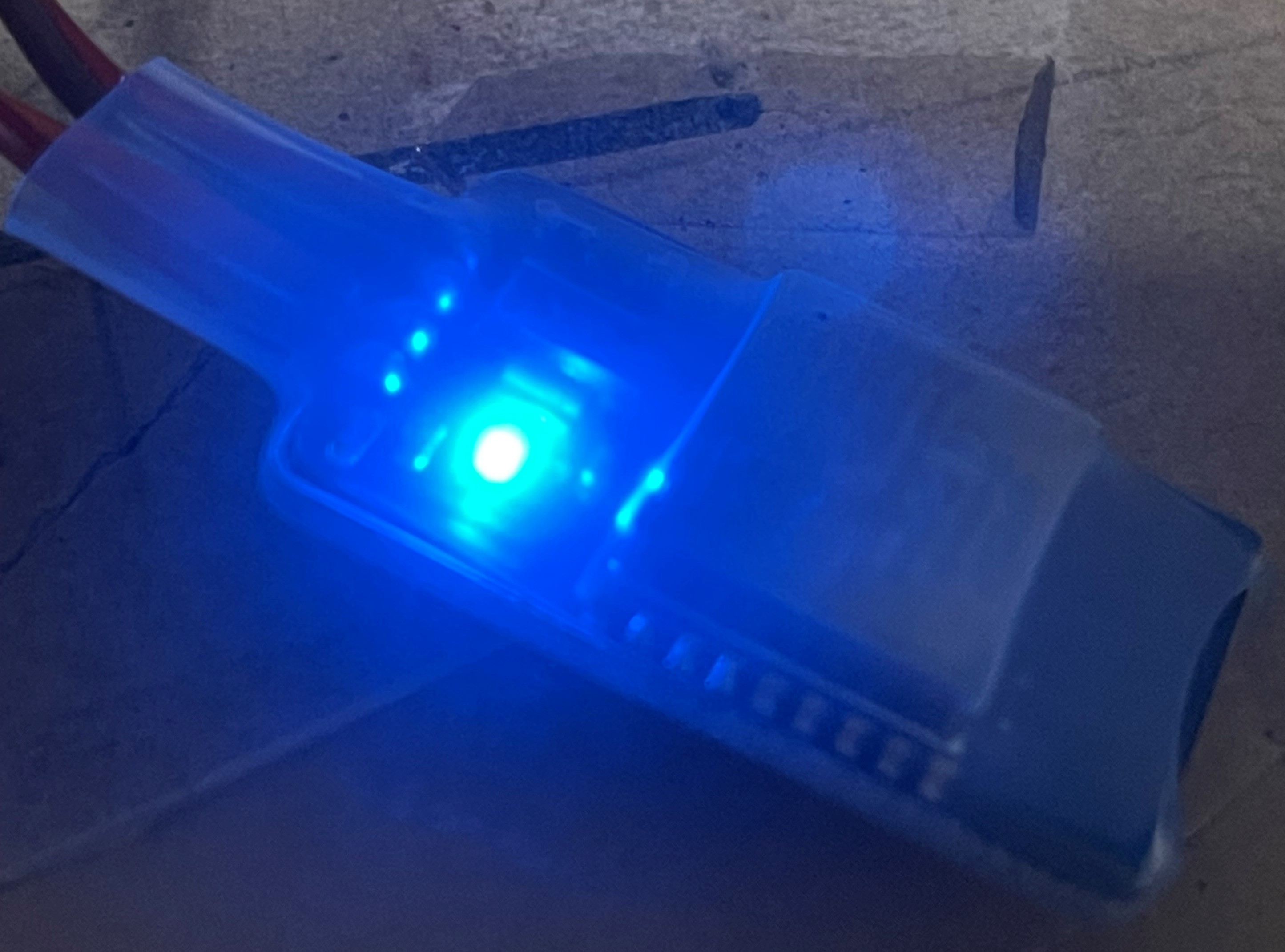

Posts: 64
Mr.Tomas,
I just received my new WiFi module. I regret to inform you that it behaves the same way as the existing one. I can get into Spirit settings via web browser but I can't use the Spirit PC program. It appears my existing Wifi unit has no issue too.
Could It be possible for you to help me to roll back to an earlier version and try. A version with 2.XX.XX. I was using this unit for sometime till it stop working recently. The last version I had use it could be V2.XX but I cant remember exact. After upgrading to latest version V3.3.3 this is the first time I am trying to use the wifi link.
For your information, I had ordered it on year 2018 together with the SP Pro FC.
Regards,
Amal
