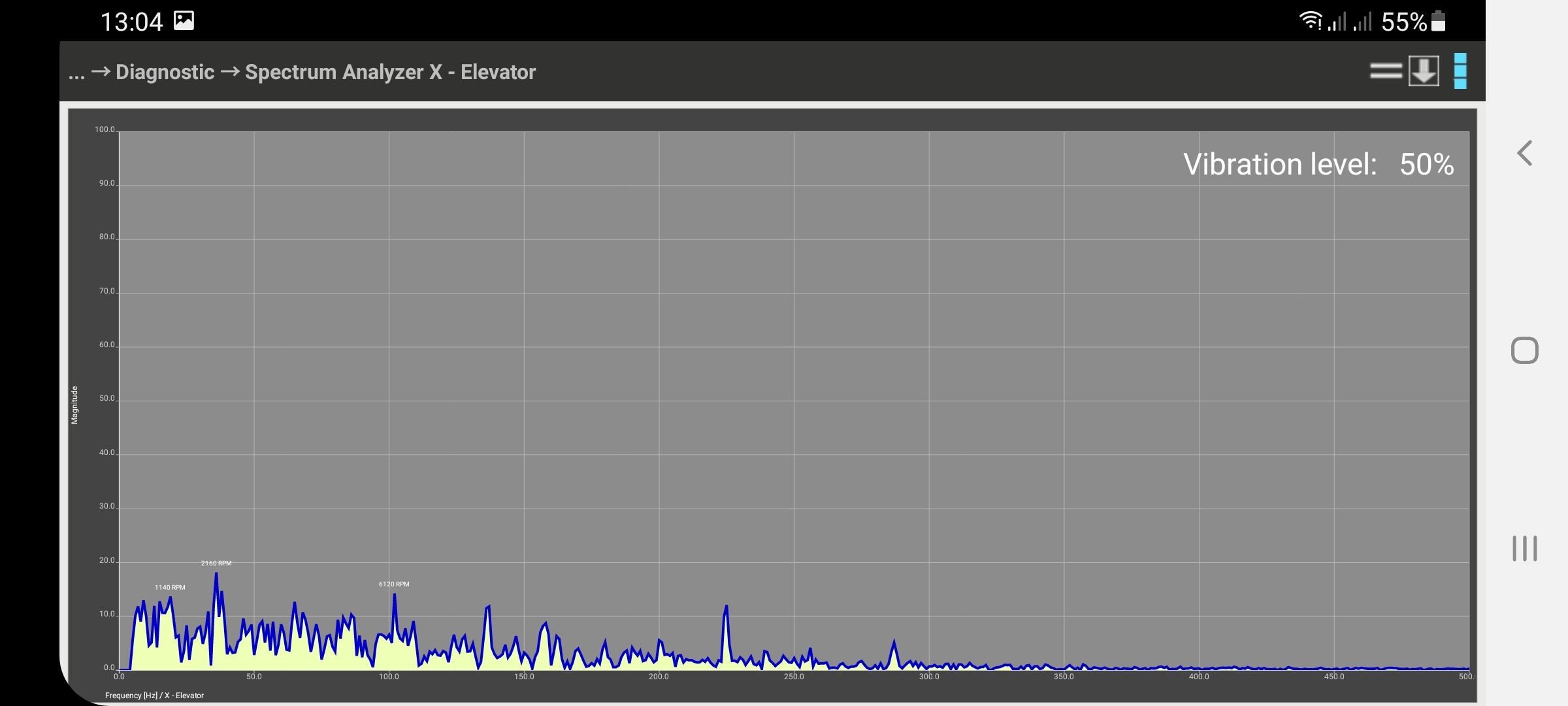

From Vibration analysis it is easy to locate and find the problem. So if you can provide me a vibration plot I can help.
zino
Posts: 59
Joined: Mon 03. Jan 2022 18:08:45
Hi. I will try to post the vibes analysis.

zino
Posts: 59
This is with tail blades on. Thanks. Please let me know
